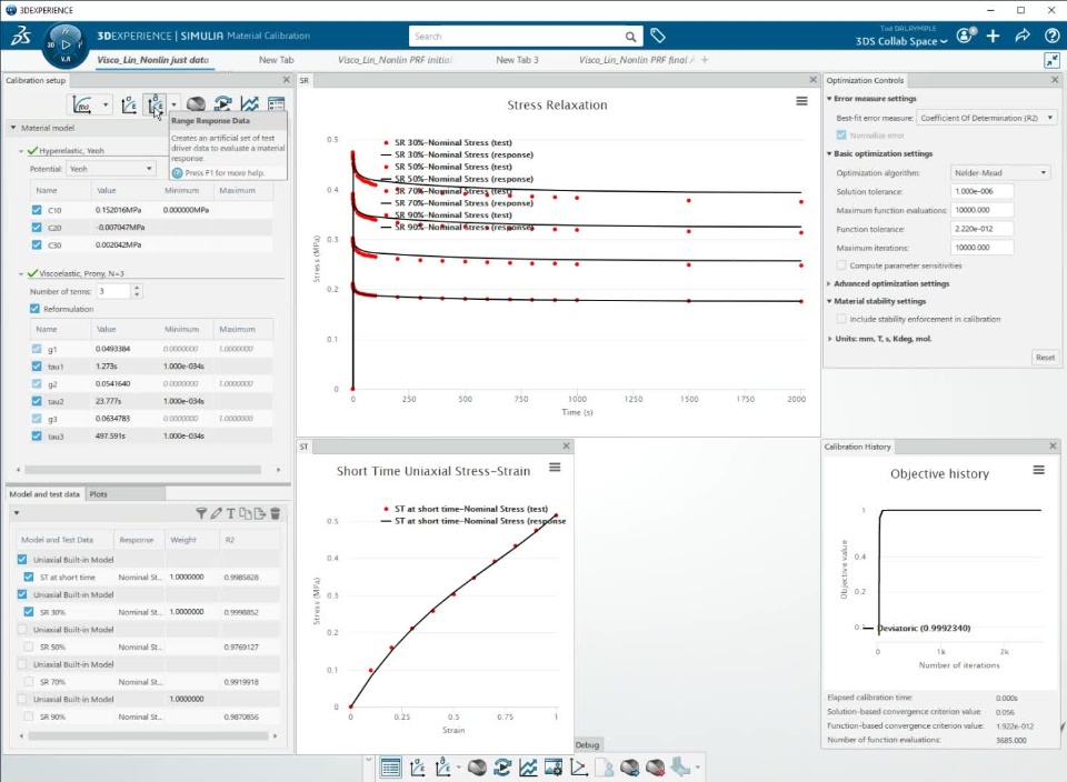

In this particular calibration example, we have focused on a strategy of using a high-rate simple tension test to calibrate the instantaneous hyperelastic model (a Yeoh model).  Then we have used simple tension stress relaxation test data to calibrate a Prony series, we start with a Prony series because we understand how to calibrate it well.  Then we convert the Prony series parameters to a degenerate (linear) PRF model, in which the parameter n=1 and the parameter m=0.  We then use the 3D Experience Platform material calibration app to refine the PRF model parameters, creating a nonlinear viscoelastic model for the elastomer.  The video below was created using a development version of the material calibration app that is close to the R2021x FD05 release that will be released on-premise on Feb 26, and upgraded to the public cloud on March 13, 2021.

ST_Visco_2.xlsx   -   the Excel file containing the raw data for the elastomer, use tab named "Raw Data for MCA"
Visco_Lin_Nonlin_just_data.3dxml  -  A 3dxml with the test data already imported.
Yeoh_curve_fit_ST.xlsm  -  the Excel file used to curve fit the hyperelastic part
Prony to Norton Conversion_3gs.xlsx  -  the Excel file used to convert the Prony parameters to a degenerate PRF model.
