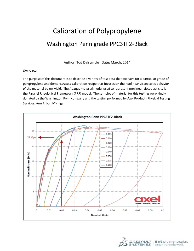

In this example, we use some test data provided by Axel Products for a polypropylene material.  This polypropylene exhibits more nonlinearity in its viscous behavior than the elastomer of our previous post.  In the attached PDF document, we show some of the test data we have for this particular polypropylene, then we march through the process of calibration.  In all of our examples, we like to paint a recipe, or strategy, for the calibration process. In our examples on calibration of the PRF model, we start with first creating a hyperelastic-Prony viscoelastic model.  We do that because it is easy to do and helps us: i) show that the material exhibits nonlinear viscous behavior, and ii) form a basis for some of the PRF parameters.

The PPC3TF2 Polypropylene test data used in this example is attached as a zip file.  This zip file contains data for the highest rate test and the 4 stress relaxation tests.  The high rate test data is called "partial" because I used just that part of the dataset up to about 20MPa.
The fuller set of test data for PPC3TF2-Black can be found here: Washington Penn Polypropylene, tested by Axel Products
