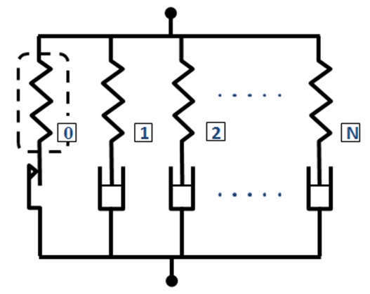

In previous posts, we have described both hyperelasticity and linear, or Prony series, viscoelasticity.  This post assumes an understanding of those previous subjects.  Beginning in Abaqus version 6.12, we added a capability to model nonlinear viscoelasticity with a generalized nonlinear Maxwell model, sometimes referred to as Maxwell-Wiechert, or just Wiechert.
  http://en.wikipedia.org/wiki/Generalized_Maxwell_model
This nonlinear viscoelastic material model is referred to as the Parallel Rheological Framework model, or simply the PRF model.  It has been extended in both 6.13 and 6.14 versions of Abaqus to include plasticity, Mullin's effect, and can be used with *TRS.
