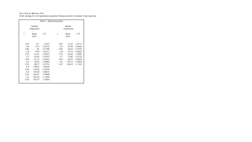

There is an interesting paper from Kossa & Berezvai titled, Novel strategy for the hyperelastic parameter fitting procedure of polymer foam materials. (DOI: 10.1016/j.polymertesting.2016.05.014).
In that paper the authors show some experimental data in Table 1 that is included here in an Excel file. The tab "orig test data" gives the data as shown in the paper. The tab labeled "reformatted" puts the data into a format to be used with Abaqus tools.

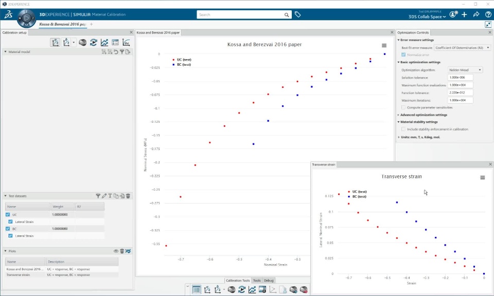

3D Experience Calibration App
The video below shows how to use our 3D Experience calibration app to calibrate the hyperfoam material model using this test data.  The hyperfoam functionality shown was delivered in the on-premise 2020X FD02, aka FP2014, release.
