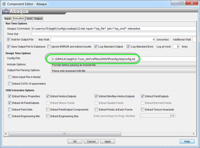

This parsing can be personalized changing the Abaqus component configuration file. In the Execution tab of the Abaqus component it is possible to point to a user configuration file. The Abaqus component configuration file allows you to determine which parameters will be extracted from the ASCII Abaqus input (.inp) file and data (.dat) file when using the Abaqus component. Specifically, it controls parsing of the Abaqus input file and the Abaqus data file.

One of the first way to proceed is to modify the Abaqus component configuration file. If some unnecessary keywords are commented out from the Abaqus component configuration file, the parsing can become much quicker.
An example can be an Abaqus input file containing a large number of materials, but the user is only interested in modifying the step properties. In this case you would want to comment out all the keywords but the *step. This will make the parsing much faster.
