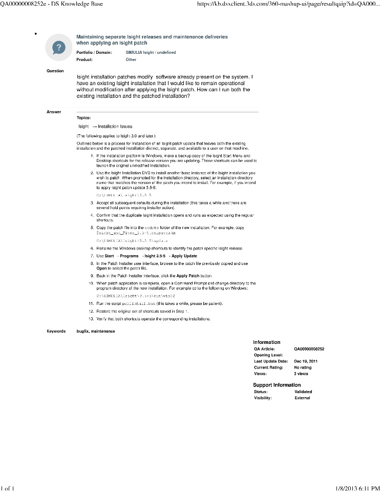

Isight maintenance releases are delivered as .esipatch files and one updates the already installed Isight release using the .esipatch file. However there are situations where one is required to retain the original Isight installation and also have the maintenance release. KB Article QA00000008252 details the procedures to accomplish this.  For the sake of viewers who are not able to view the KB article, a copy of the article is attached with this post.
In this post, I am adding some more details to the already published article.
