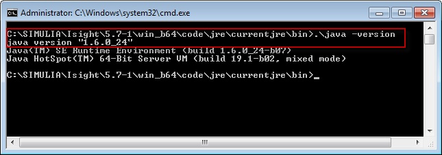

To determine what java version your Isight installation is using, run the java -version command using the java executable available in the Isight installation, like in the below figure :

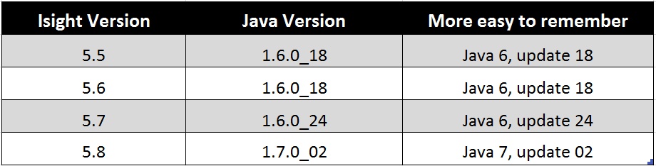

Following is the list of java versions that are available with various Isight releases :
Java 1.6_028 translates to Java 6 update 28. Dont ask me what happens to the 1 in-front of the version number. Ask Java.
