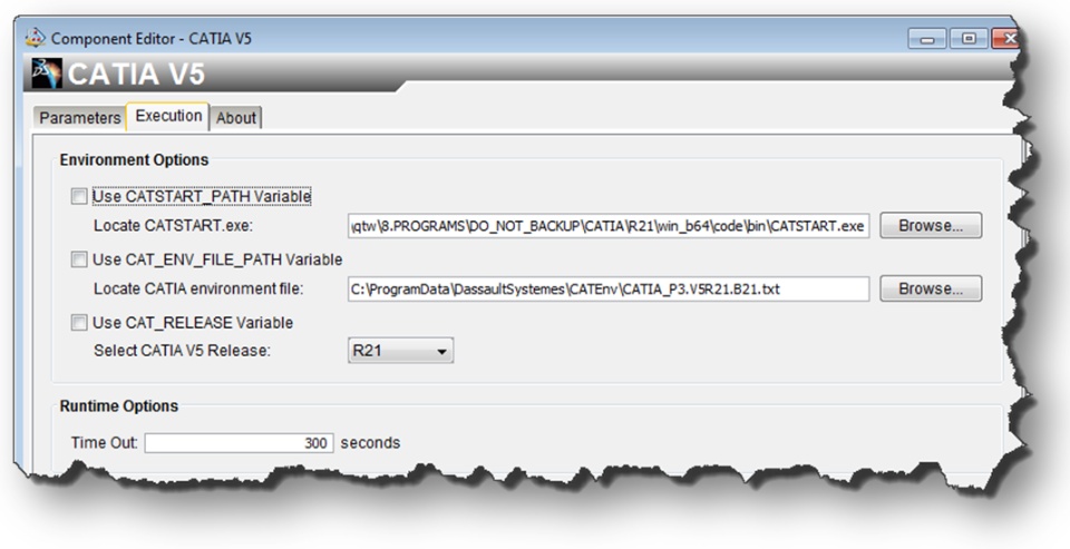

What I require to use this component?
You will require :
  1. Isight 5.7 or later
  2. An Environment File, which is  a text file that contains information on the various paths of the CATIA V5 installation. If you have a local installation, this file is usually found at "C:\\ProgramData\\DassaultSystemes\\CATEnv". If you donot have local installation or if you don't find the file, contact your administrator.
  3. The path to CATIA V5 exectuable, CATSTART.exe
  4. CATIA V5 Version
These can be set in the execution tab of the CATIA V5 component editor or set using environment variables, like shown below :

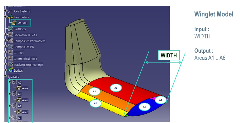

The usage of this component is best explained through an example. In the example, a CATIA V5 winglet model shown below is used.The goal of the example is to use Isight to modify an input parameter in Catia, update the model and measure the updated outputs from CATIA. The input to the component is a parameter called WIDTH, which is the width of a profile in CATA Model. This is actually an user-defined parameter in CATIA and is associated with a sketch dimension of the profile. The output is the summation of the areas  A1.. A6. ( A6 is not shown ).

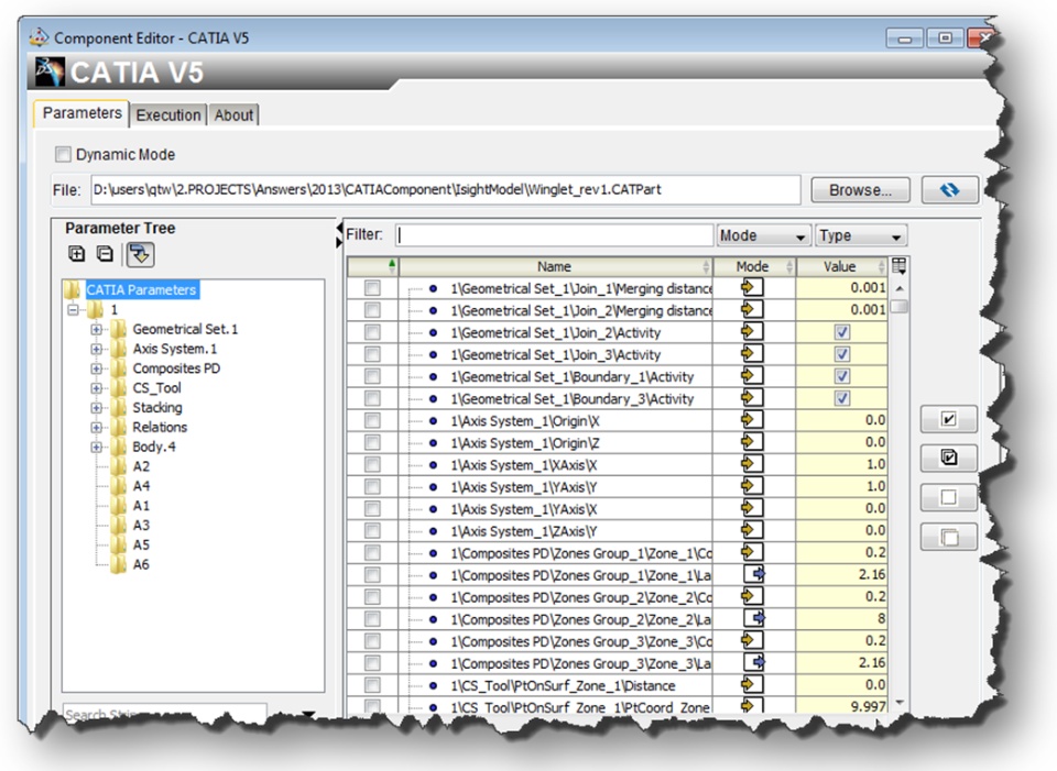

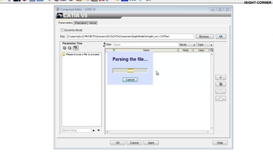

After setting up the execution options in the component editor, the CATIA part file should be selected in the parameters tab. Then Isight will automatically parse the file to read outthese parameters, much like the Abaqus component.
in the list of parameters shown, the WIDTH and 6 areas need to be selected.  An epilogue script is used to add these 6 areas to form one single Area parameter.
