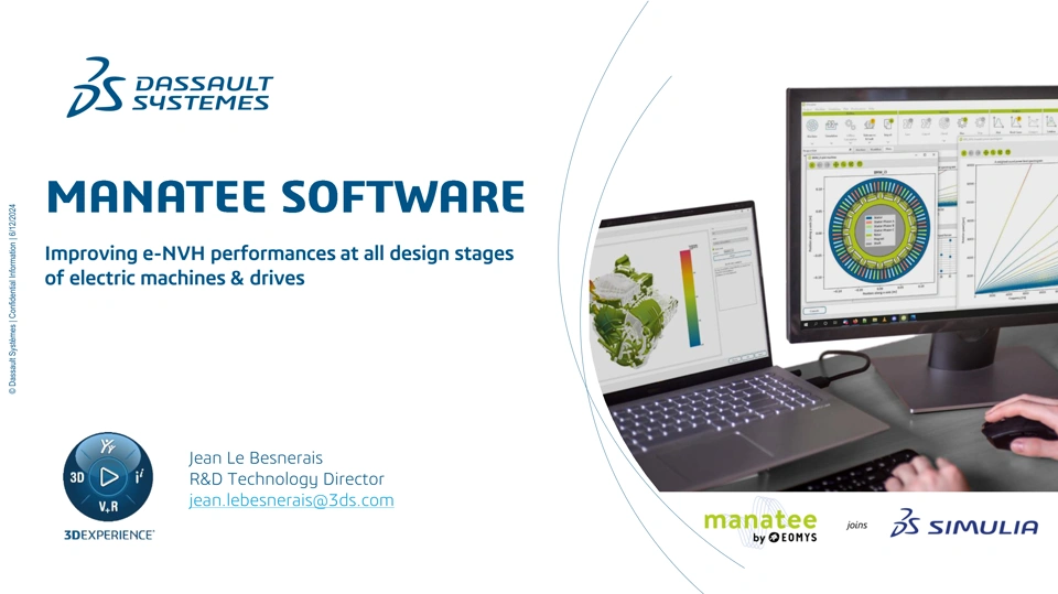

@JB held there the presentation titled "Introduction of SIMULIA Manatee Software for Magnetic Noise & Vibration Control of Electrical Systems".
PDF Slides:
Abstract:

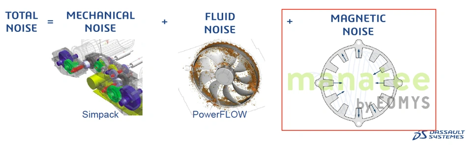

Acoustic noise and vibrations due to electromagnetic forces due induced by electric machine operation (called e-NVH in automotive applications) can be significant in many applications such as transportation & mobility, industrial equipment, aerospace & defense, marine & offshore, etc. Tackling noise issues after manufacturing can be particularly expensive and may degrade electric drive performances such as efficiency, cooling, and weight. Therefore, an efficient virtual prototyping workflow of e-NVH is key to accelerating development times, reducing prototyping manufacturing & testing costs, and improving engineering productivity.
Manatee software is a CAE collaborative environment designed to support all engineers involved in the development of electrified systems to assess and control magnetic noise and vibration levels at all design stages, from the basic electric motor design stage to the system-level detailed design stage. Manatee can be run as a standalone multiphysic software with flexible modelling options for electrical, magnetic, structural dynamics & acoustics. It also comes with high interoperability, allowing flux import from CST/Opera and modal basis import from Abaqus. It comes with predefined simulation workflows and specialized magnetic noise mitigation techniques (e.g. skewing, notching, harmonic current injection) which makes it complementary to general-purpose software solutions of Simulia portfolio. Manatee facilitates collaboration between engineers (electrical, control, mechanical, and NVH engineers) while standardizing the interfaces between electric machine designers and integrators.
