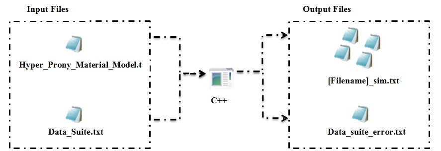

The new calibration tool was migrated from Fortran to C++. It allows the use of different Hyperelastic models like Neo-Hooke, Yeoh, Ogden (order N=1 to N=6), Arruda-Boyce, Van Der Waals and Mooney-Rivlin. However, until this date, only the integrated calibration with Neo-Hookean, Yeoh and Ogden are validated.
The image above is an overview of the calibration tool workflow with all necessary input files and generated output files. The attached documentation gives a more in-depth explanation how the program works, the format requirements for the different files, the used error norm and some general considerations about the use of the program.

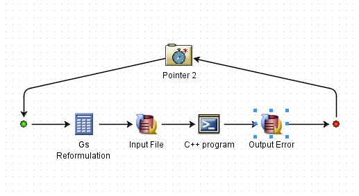

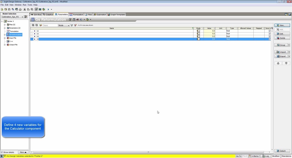

Isight Model
One of the big issues on the material calibration subject is the diversity of possible answers. That makes the process more difficult in the sense of defining which one is the best. With that in mind different Isight models were tested, with the goal of getting a configuration able to produce good results consistently. The suggested Isight model is based on the previous models with some differences: it uses Pointer-2 as the optimization algorithm and a  calculator component to constrain the g prony terms values. All the detailed information about this model is present on the attached documentation.
