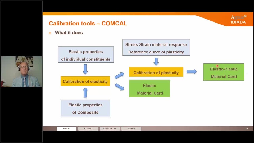

Some polymer parts are injected from polymer matrix mixed with glass fibers to improve stiffness and other mechanical properties. Therefore, the injected parts show direction dependent material properties based on fiber local orientation and concentration. In our approach fiber orientations and fiber concentrations are mapped from injection molding simulation to a structural model. Goal is to calibrate anisotropic material model based on tools already present in FE solvers so once a material model is calibrated no license or user subroutines are needed to use this material card. The procedure is based on Mean-field homogenization approach which is a semi-analytical homogenization approach to predict thermal and mechanical properties covering elasticity, plasticity, viscoelasticity and damage, i.e. general enough to be used in large range of contemporary simulations. Our current solution consists from two tools: 1) Mapper; 2) Calibrator. The mapper is a plugin for Ansa (Beta CAE) pre-processor and the calibrator is a Python program with rich GUI interface for semi-automatic anisotropic material model calibration based on material coupon tests. Current solution is limited to Abaqus solver, but the idea is to extend the solution to PAMCRASH and LS-DYNA.
