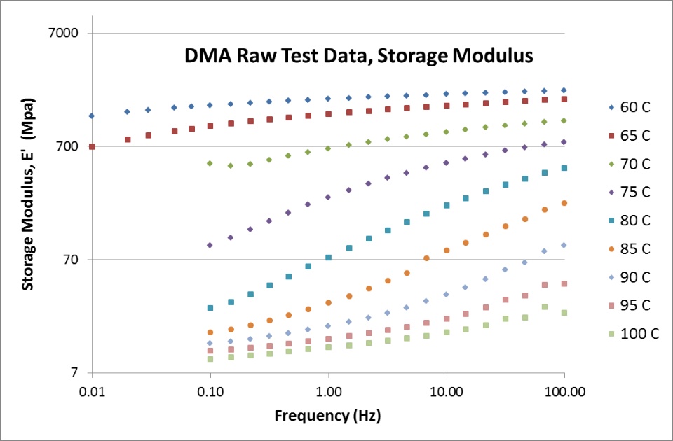

New functionally has been added to the calibration app in the 3DExperience platform allowing the user to generate a master curve from DMA test data across various temperatures.   A typical set of test data is shown above. This new feature will be available in Feb, 2023 with the release of R2023x FD01.   This workflow, with a target material model of Hyper-Prony-TRS, was demonstrated several years ago using Excel.  You might want to read this earlier post to better understand the workflow:

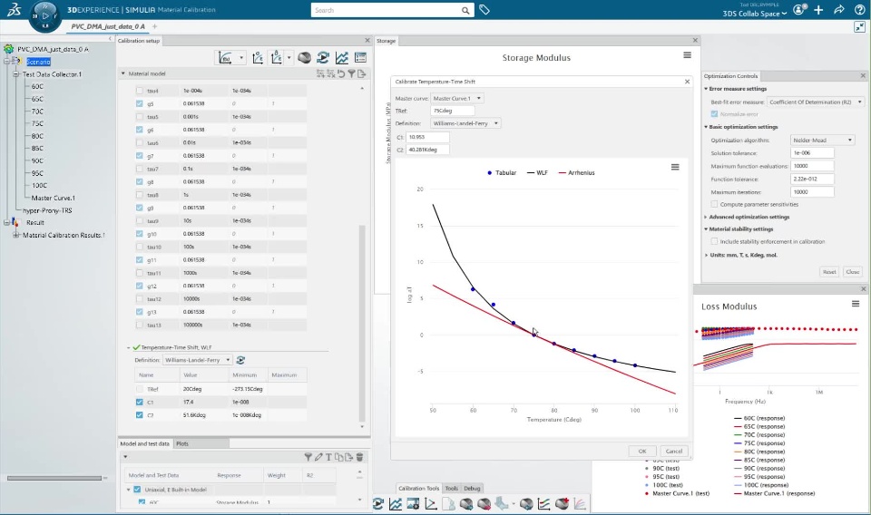

           The master curve is created as a new piece of test data.
           The shift factors from the master curve creation are then used to calibrate the TRS parameters.
           The master curve can then be used to derive a Prony series.
The video below was created on Dec 8, 2022 using a development version of the calibration app that will look very similar to the R2023x FD01 release (Feb 11, 2023).
Some key take-always:
  • After creating the master curve, it is important to get the TRS part correct before dealing with the Prony series.  Remember that the master curve has an associated temperature
  • All of the test data information is accumulated into the master curve, you can base the entire calibration on the master curve data (no need to use the other data).
  • It is important for this case to set the error norm to RSE (Relative Square Error)
  • The Differential Evolution optimizer is good for this case.
