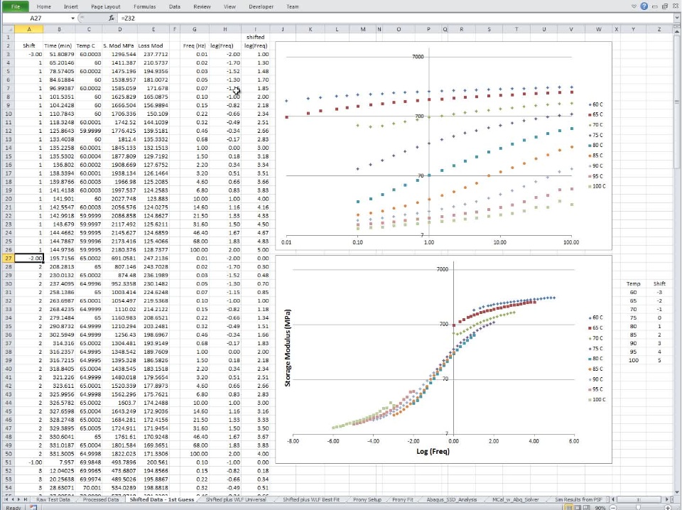

The test data pictured above, and included in this post was kindly donated by Professor David Jack of Baylor University. In his class on viscoelasticity, his students perform a variety of measurements, including DMA testing. His former student wrote the honors thesis you can find here.
Professor Jack was kind enough to share the raw test data for the PVC material that is shown in the honors thesis (Chapter 4, see for instance, Figure 4.8). This post will step through an Excel spreadsheet in which we:
- Shift the 9 separate pieces of test data (from 9 temperatures) into a Master Curve.
- Show how to use Frequency shift information to derive WLF parameters.
- Show the derivation of Prony parameters to match the Master Curve.

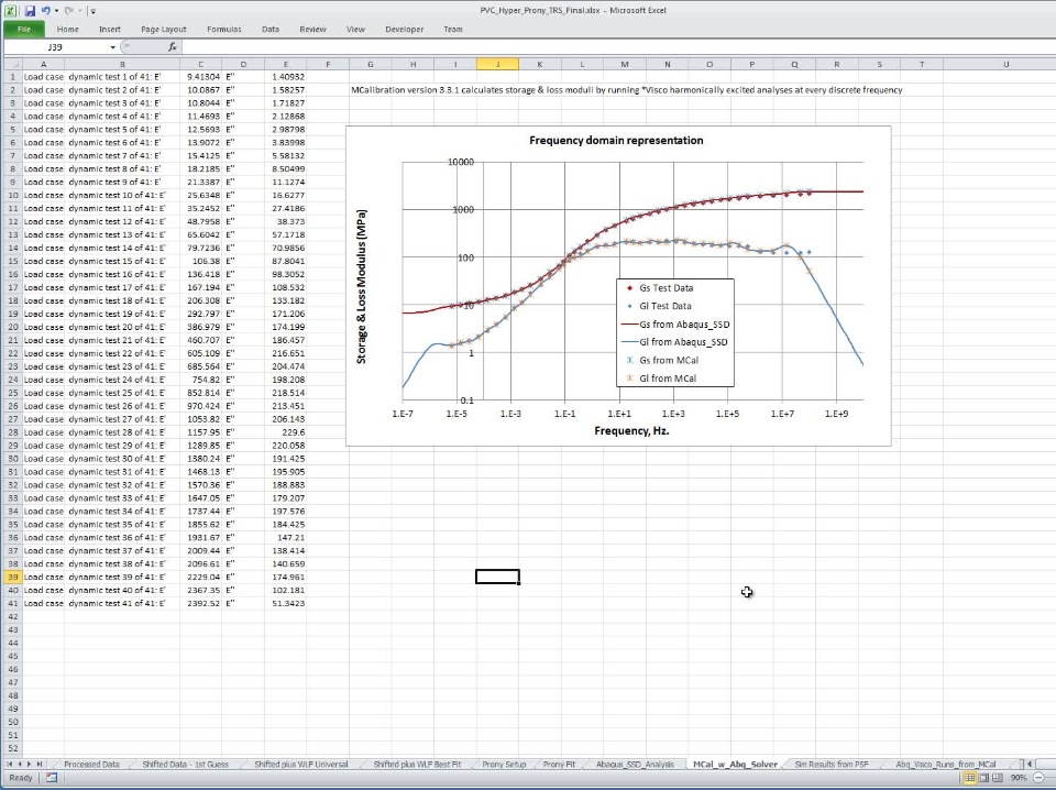

- Validation of the Prony series / Master Curve using an Abaqus SSD analysis
- Validation of the Prony series / Master Curve using MCalibration (by Veryst Corp.)
- Validation of the entire Hyper+Prony+TRS model using a PSF script
- Validation of the entire Hyper+Prony+TRS model using MCalibration

PVC_Hyper_Prony_TRS_Final.xlsx This is the Excel file shown in the videos
Visco_Harmonic.inp This is the template unit-cube model used for validation (driven by .psf python file)
Run_All_Harmonics.psf This .psf file runs the 9 temps x 19 Frequencies = 171 analysis runs
