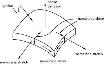

Abaqus offers two primary formulations for gasket elements: regular gasket elements and normal-only gasket elements.
Regular gasket elements have 3 degrees of freedom per node that can model an uncoupled membrane, transverse shear, and through-the-thickness behaviors,
Normal-only gasket elements have one degree of freedom. They model through-thickness behavior only. Normal-only gasket elements are more numerically cost-effective than regular ones but aren’t as common.

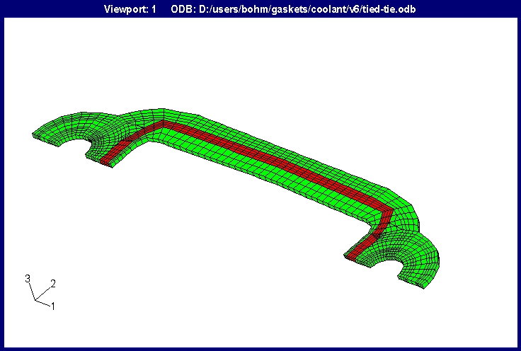

Often, gasket meshes have one gasket element through the thickness. The different colors in the gasket mesh shown here represent different gasket behaviors. The red mesh has a different gasket behavior from the green mesh.
Dynamic gaskets have damping defined by viscoelastic properties. There are gasket elements that have temperature degrees of freedom at their nodes, allowing heat transfer through the thickness direction.

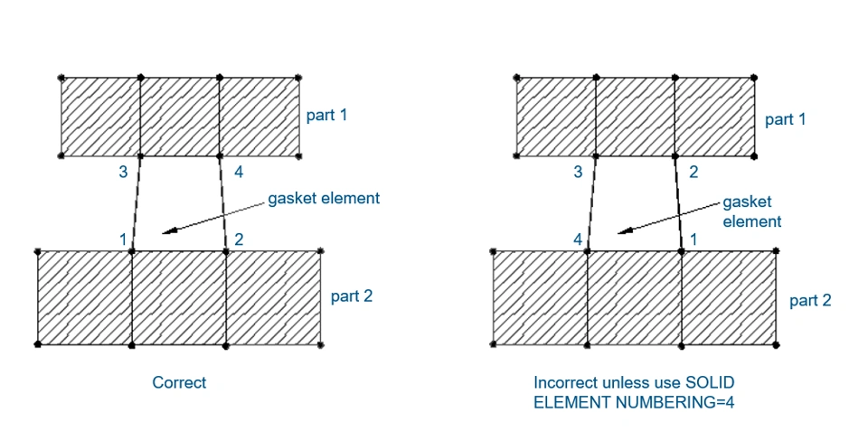

Gasket element connectivity can differ from solid element connectivity. Numbering the nodes of the gasket is crucial since it defines the gasket’s normal direction. If necessary, use the solid element numbering parameter on the element to work around this difference. This can be convenient if the mesh generator does not support gasket elements or in thermal stress analyses where continuum elements are used to model the heat conduction in the gasket.
Fortunately, Abaqus/CAE supports gasket elements. The user can make a gasket mesh with the correct thickness direction; however, you may have to rearrange the nodal ordering on the element definition to get the correct thickness direction in some cases. Output to the data (.dat) and output from Abaqus/Viewer will use the normal gasket element connectivity.
Example
Here is an example showcasing the correct way of numbering a gasket element. The right-hand picture defines the element in the order 1-2-3-4, which only works for a plane strain element or a plane stress element, CPE4 or CPS4.
In the context of a gasket element, the thickness direction must extend from the bottom flange to the top flange. Hence, a crisscross connectivity pattern is imperative. So, if you wish to use the right-hand picture’s numbering method, you would have to declare that solid element numbering equals four. This would tell Abaqus to consider the fourth side of this element, defined as an ordinary element, as the bottom of the gasket.

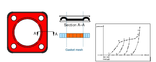

Gasket Element Geometry
Consider the example below to model our complex gasket with a simplified mesh. The left image shows a cross-section of our complex gasket geometry in section A-A, featuring strategically placed bumps to induce ceiling pressure. However, a gap in the central region requires substantially depressing the bumps to reach the gasket body.
Our approach involves modeling this cross-section at the bottom to represent our gasket mesh. We exert pressure on the section to account for the gap and bumps, determining the force needed for gasket closure. This is achieved by defining a pressure closure curve within the element in Abaqus, accommodating complex mechanical responses in the thickness direction, including the gap effect. The pressure closure definitions in Abaqus allow us to account for the complex mechanical response in the thickness direction, including the effect of the gap.
Due to differences in the gasket’s middle cross-section and bumps, we define distinct behaviors for each scenario. Gasket definitions in Abaqus/CAE are achievable, with some details obscured for simplicity. Abaqus/CAE offers a comprehensive toolset for gasket definition.

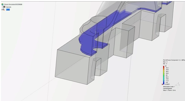

Furthermore, the 3DEXPERIENCE platform supports gasket behavior in the material definition app. This integration enhances the versatility of gasket modeling within the broader computational framework.

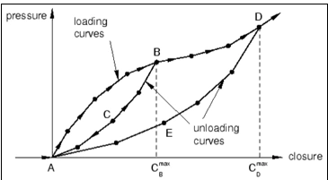

Gasket behavior in Abaqus is defined using pressure closure curves, material definitions, and the choice between damage and elastic-plastic behaviors. The pressure closure curve is obtained by testing the gasket in a machine and extracting the necessary data to define the behavior.
Abaqus provides options for inputting how the gasket area changes, particularly for line gaskets. This data is then used to define the gasket behavior, with two basic types: damage and elastic-plastic. The damage type involves a nonlinear elastic response that may include the effect of damage, while the elastic-plastic type includes a plastic or residual closure upon unloading.
What is Damage Behavior?
TYPE=DAMAGE defines a non-linear elastic response that may include the effect of damage. INTERPOLATION=DIRECT is used if there is a problem with unloading curves not following the input unloading curves.
If, for instance, a gasket exhibits unexpected behavior, deviating from the specified curves, it is advisable to explore this new option.
The resulting thickness behavior closely resembles the damaged elastic response observed in hyperelasticity, known as the Mullins effect. Upon loading the gasket to point B and subsequently unloading, if damage unloading is defined, the response returns elastically to point A. The damaged curve is traversed upon reloading, and the process continues accordingly.
A primary loading curve is defined for this type of thickness response, accompanied by a set of unloading curves. Abaqus employs interpolation to derive the corresponding unloading behavior when unloading occurs from an intermediate pressure.
