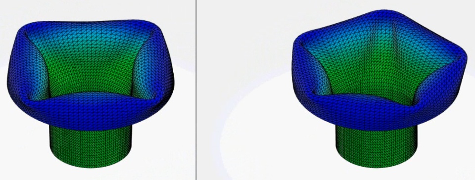

  7. (Numerical) buckling sensitivity of a "perfect" structure (4 versus 5 folds over the circumference)
  8. Unstable snap-through at the crucial point of the simulation

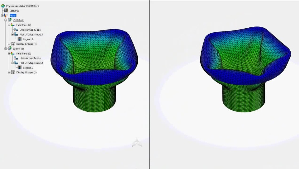

But now enough advertising, here is the video (left Abaqus/Standard, right Abaqus/Explicit):
