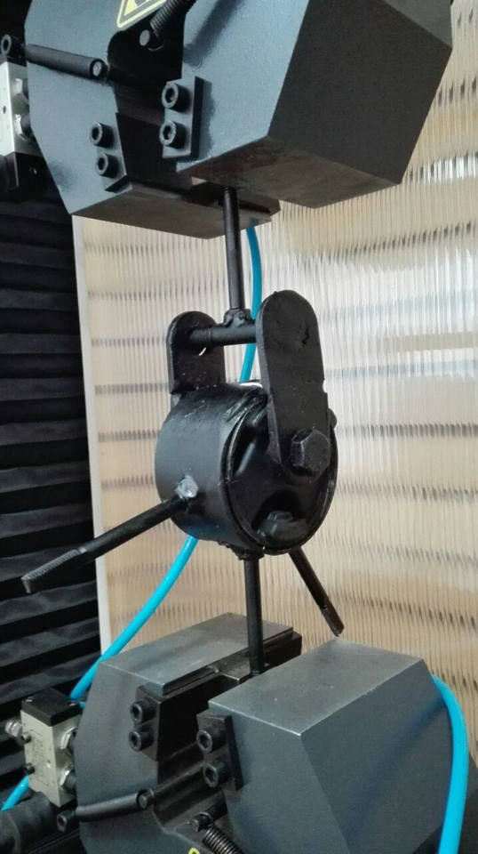

Experimental test of the engine mount

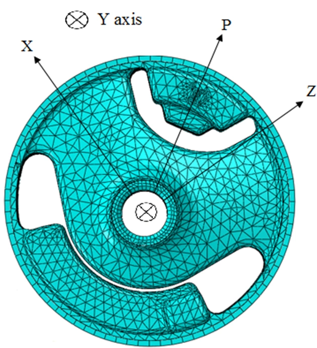

ABAQUS model and loading applied in different directions.

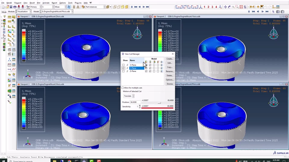

  • Static Modeling:
For static analysis, the hyperelastic properties of the engine mount were considered. The most commonly used model in this context is the Mooney-Rivlin model, which is categorized based on material hardness using the Shore hardness parameter. In this project, the engine mount material was modeled with a Shore hardness of 55.
The loading was applied in four different directions, as shown earlier.

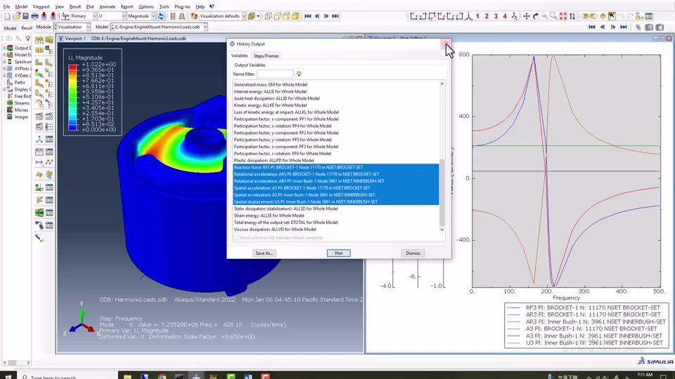

  • Harmonic Modeling of the Engine Mount:
  1. First, the engine's weight was applied to the mounts, and a static analysis was performed.
  2. A frequency analysis was then conducted to examine the engine mount's response.
  3. Finally, a harmonic analysis was performed within a specific frequency range to evaluate the engine mount's behavior under harmonic loads.

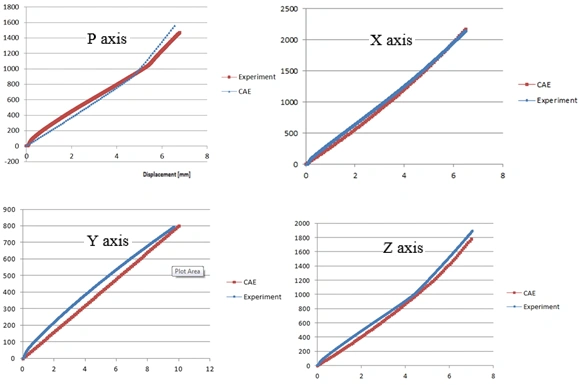

  • Experiments were conducted in four different directions to evaluate the stiffness of the engine mount.
  • Displacement values in these four directions were recorded and compared with the simulation results.

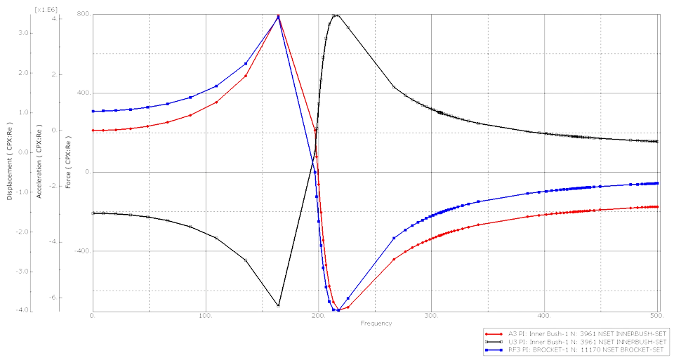

  • The results demonstrated that the engine mount effectively damped vibrations and accelerations under harmonic loads.

  • The graph below illustrates the acceleration, displacement, and force of the engine mount as a function of frequency:
    Harmonic Analysis Results
