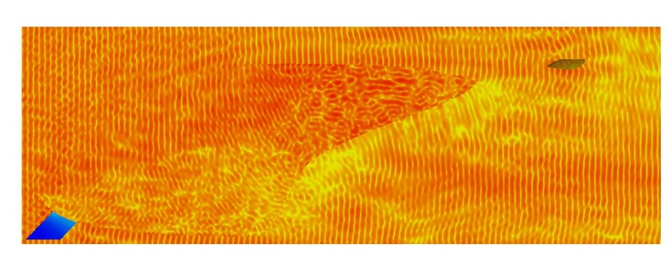

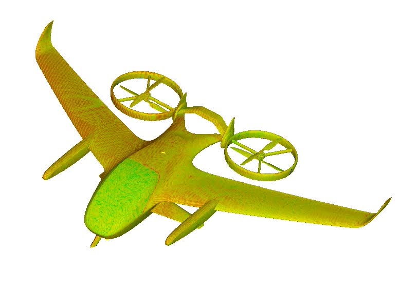

Today it does not take much to gain insight into the EMC of an eVTOL in an electromagnetic environment as HIRF ​​​​​​​ for instance. Below are animations prepared with CST Studio Suite of the external and internal field responses due to a plane wave drive.
The problem was solved with SIMULIA CST Studio Suites' TLM solver in 10.5 hours for 335,415,081 meshcells on 4x NVIDIA V100-SXM2-32GB GPUs.
Surface current density in A/m @ 3000 MHz
Magnetic field strength in A/m @ 3000 MHz
