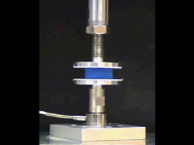

This paper is very interesting in part because the authors also shared publicly a large quantity of resilient foam test data.  The test data is for a large set of foams, and includes uniaxial compression, simple shear and volumetric compression testing.  The paper also makes the point that just testing a foam in uniaxial compression, then calibrating, may create a material model that behaves very incorrectly in shear.  It is also uncommon to see volumetric testing performed on a foam, which the authors do by way of a very interesting test apparatus (see video).

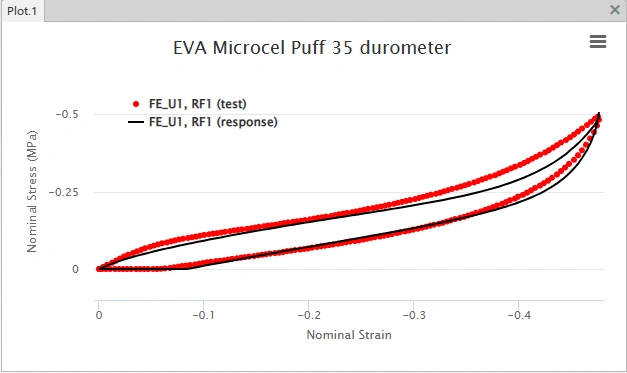

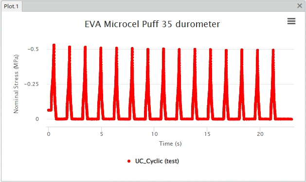

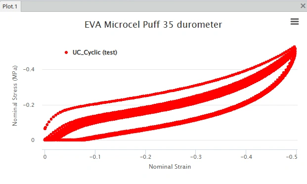

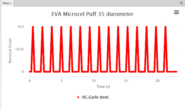

The Cyclic Uniaxial Compression data shown in the image above has a waveform like this:
And a stress response like this:
Looking at the 1st image (stress vs strain), I would conclude there is a bit of a Mullins effect in this material.  For end applications that focus on repeat loading, one might want to ignore the Mullins effect. EVA foams are often used in running shoes where the initial Mullins effect is not so important to capture.

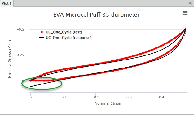

Looking closely at the strain/stress waveforms and the video below, I conclude that faithfully representing the cyclic compressive test requires a FE model with contact. The video is just a sample of the test, not the EVA foam.

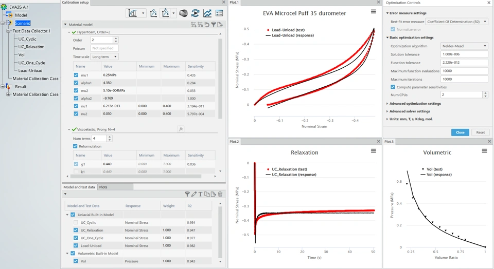

If one uses the Numerical mode in the 3DExperience Material Calibration App, the stress response during unloading (green ellipse) cannot follow the test response.
When one uses an FE model (unit-cube) with a rigid contact surface, during the unload the contact surface loses contact with the deformable body, which faithfully represents the test conditions.
This is an image from the Calibration App, using Numerical mode.  The cyclic compressive test is truncated at the end of the unload
