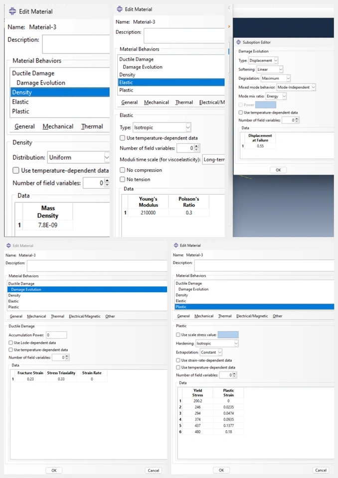

  • Material/mesh: The rod is modeled as a 3D deformable steel part with a ductile damage criterion (while the pipe is a discrete rigid body). Mesh uses C3D8R elements with enhanced hourglass control, distortion control on, and element deletion enabled. All other parts (pipe, tools) are modeled as discrete rigid bodies.

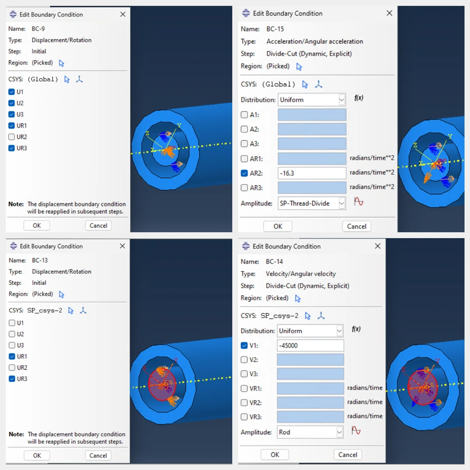

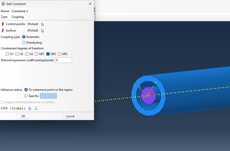

  • A reference point (RP) was created on the pipe end surface, with a coupling constraint applied between this RP (as control point) and the rod end surface. All DOFs were released except UR2, so that the rod rotates synchronously with the pipe.
  • For the RP, I applied a Displacement/Rotation BC with all DOFs fixed except UR2, and then prescribed an angular acceleration of 16 rad/s² about AR2.
  • For the rod’s end surface, I applied a Displacement/Rotation BC with UR1 and UR3 fixed, and prescribed a forward velocity of 45,000 mm/s in V1.

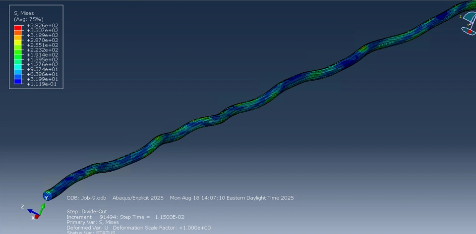

During the simulation, the rod undergoes significant unintended twisting while rotating with the pipe. Eventually, the analysis terminates with the error: "Excessive element distortion in element set ErrElemExcessDistortion".
In other words, the rod begins twisting far more than expected, even though this behavior is not physically intended.
