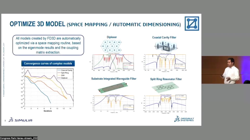

Filter Designer 3D (FD3D) is an advanced synthesis tool to realize filters and diplexers. The user-friendly interface in addition to several template examples provide an easy understanding of the workflow with advanced design and visualization features that support Lowpass, Highpass, Bandpass, Bandstop and Diplexer designs. FD3D empowers the designer with access to various filter responses that can handle different transmission zeros adding more flexibility and the ability for group delay equalizer design. The tool supports several topologies in different guided-wave technologies including planar, cavities and lumped element filter implementation.
Filter model creation in FD3D is fast and robust thanks to the assembly procedure that allows user-defined building blocks in the component library followed by an automatic parameter mapping and simulation project set-up. All models created by FD3D are automatically optimized via a space mapping routine, based on the Eigen-mode results and the coupling matrix extraction. By default, the built-in Trust Region Framework optimizer with FD3D goal utilizes sensitivity results to greatly speed-up the optimization routine.
