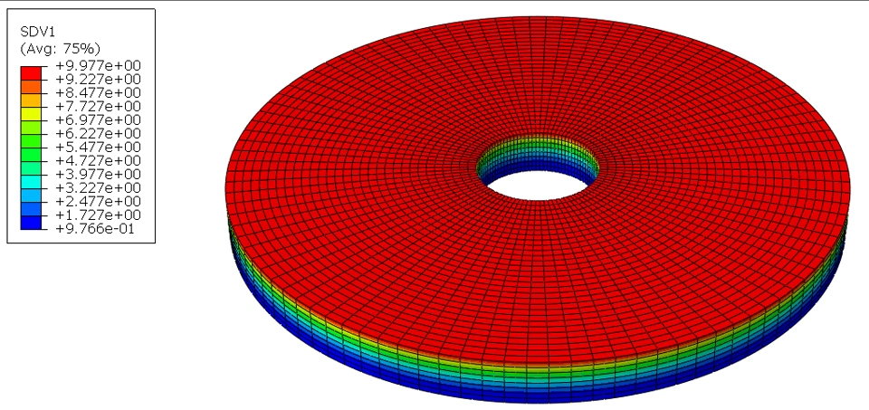

Visualization of State-Dependent Variables (SDVs) for Young's Modulus in FGM
