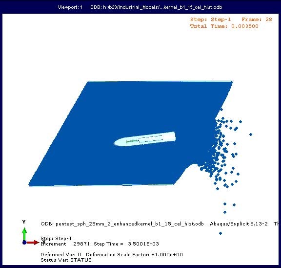

 FE model used in the SPH simulation consisted of 64800 C3D8R elements results in 589000 PC3D elements. Steel cover of 5mm thickness has been modeled using shell elements and general contact has been defined for particle and shell elements.

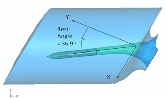

Results obtained from SPH simulation in comparison with test data and CEL is summarized in table below
Projectile tip X' (m)
Projectile tip Y' (m)
Path Length      (m)
X'-Y' Rest Angle (degrees)
No. of CPUs
Total CPU Time
TEST
0.62
0.69
0.93
43.00
CEL
0.60
0.78
0.98
37.69
16
~ 11 Hrs
SPH
0.57
0.77
0.96
36.35
1
~ 98 Hrs

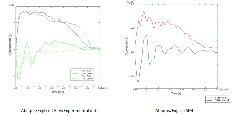

As presented in above figure axial and lateral accelerations obtained from SPH simulation follow the general trend of acceleration plots obtained from CEL simulation and experimental data.
