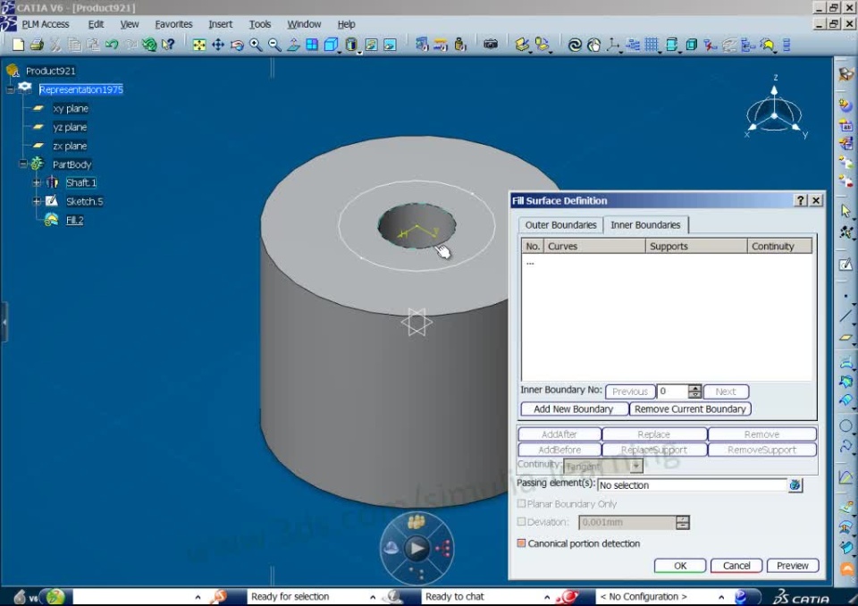

1) The profile of the surface that will aid in creating the partition is sketched.
2) The surface which will be used in the partition process is generated using the Fill tool. The sketch created in step 1 is set as the outer boundary and the hole with the smaller diameter of the cylinder is set as the inner boundary.
3) Using the Sew surface tool, the previously created surface is sewed into cylinder thereby creating a single part.
