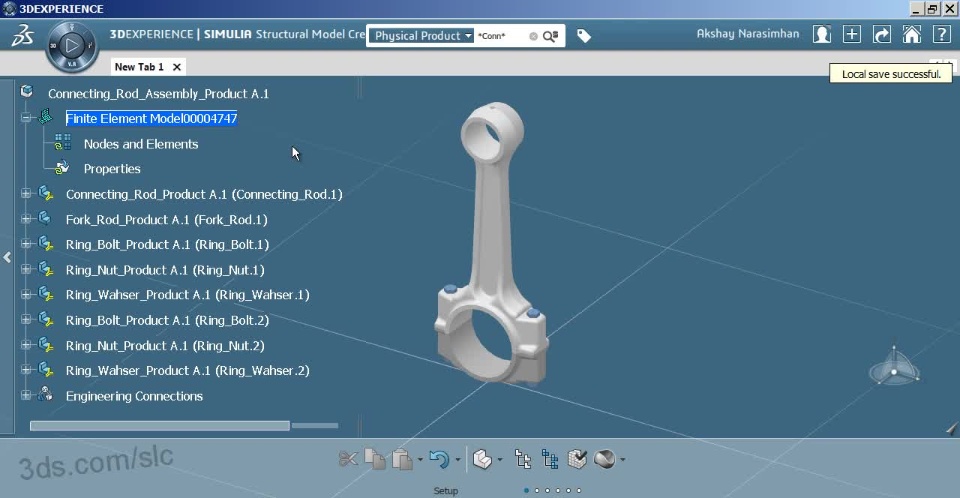

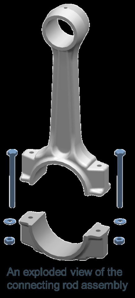

Now, let’s look at a simple example to understand how you can create a FEM Rep by combining both the previously discussed workflows. Assume a connecting rod assembly consisting of 5 unique parts and 8 part instances.
  • Connecting Rod
  • Fork Bolt x 2
  • Nut x 2
  • Washer x 2
In this video, we will create the mesh parts for the connecting rod and the fork in the global FEM Rep using both the MoA and AoM workflows.
