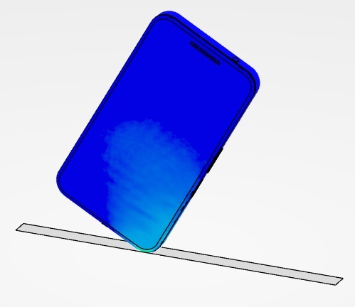

For the phone drop test the Engineer first setup the phone so that is would be dropped onto its corner from a 1m height and at a speed of 4.43 m/s. Through the power of simulation, the Engineer could be certain that the phone would be dropped at the same speed, the same angle, and the same height for every experiment. This assurance allowed the Engineer to change other variables and be confident that those changes would be the only variables effecting the results.
Second Step: Testing Each Variable Change
You will be happy to hear that they did NOT have to drop hundreds of phones for this experiment! Instead, the Engineer was able to change certain characteristics of the phone while rerunning the drop tests. For each drop test, the Engineer observes how much damage had been sustained by the screen on impact.

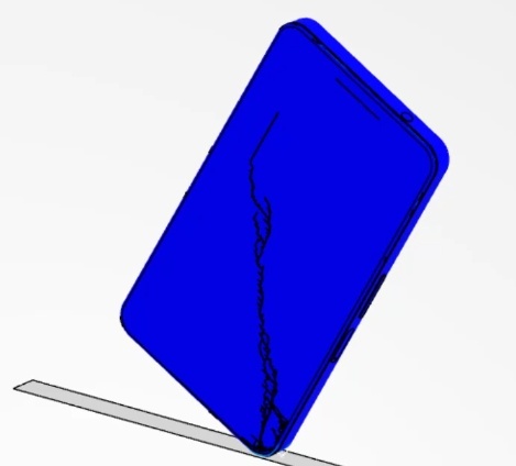

After running the simulation the designer was able to determine that changing the glass material avoided the hairline crack, but there was still a damage to the bottom right corner. Further optimization had to be done to avoid this.
Here you can see the undesired damage to the bottom corner of the phone

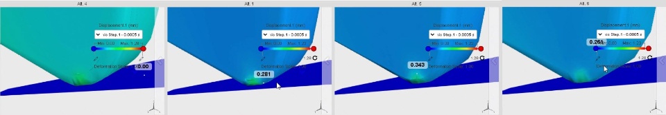

After running the simulation the principal engineer was able to determine that tests 1, 2, 6, and 7 produced results where there was the least amount of strain on the plastic. Using those different tests, the engineer can also perform a visual inspection of the results.
Comparing the damage between the top four results with the least amount of plastic stress

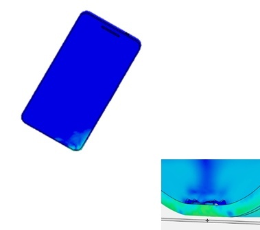

As you can see above, option six (the far right result) was the only result the did not produce any cracking in the screen.
Before
After
So here are the before and after results…what do you think? I know which one I would rather have in my pocket, and so do phone manufacturers.
