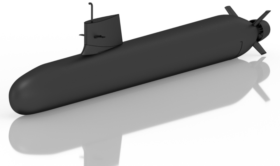

Modeling the submarine
Figure 1: View of the external casing of the entire military submarine model
The workflow to reduce detectability begins early in development. The sooner stealth factors are considered, the less risk there is of problems being found late in testing, and the more potential there is to find an optimal solution. As soon as the initial CAD model of the hull is available, work can begin.
The project begins by making full use of the “Requirements, Functions, Logical and Physical” (RFLP) data model to build the CAD model shown in Figure 1. The model geometry was built with CATIA roles, with parameters allowing optimization later, and therefore it can be made immediately available for simulation on the 3DEXPERIENCE platform. The CAD model is more detailed than is needed for the simulation, so automatic de-featuring increases simulation performance.

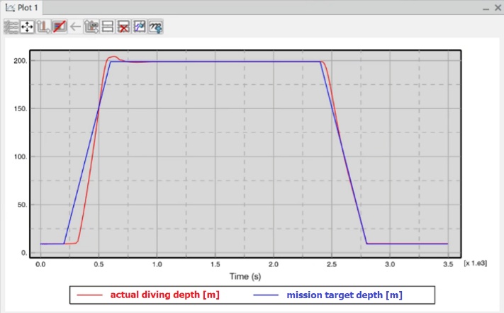

The submarine system’s dynamic behavior is modeled and simulated using the Dymola Behavior Modeling (DBM) application, which is an integrated 1D-modeling and simulation environment on the 3DEXPERIENCE platform. DBM directly generates multibody system models from CAD data and provides 3D visualization and animation capabilities of the system behavior. This is used to generate a multibody model of the submarine including control surfaces. With this, users can study the hydrodynamic behavior of the submarine under varying operational conditions or drive strategies. The control systems of ballast tanks can be accurately modeled, in order to realistically represent surfacing and diving behavior. Different drive units – for instance, diesel engines or fuel cells – can also be considered in the simulation.
The results of the control system simulation are compared with the test requirements (see Figure 2). If they are not met, the model parameters and topology can be modified through an iterative process until the target behavior is achieved.
Figure 2: Results plot of submarine hydrodynamic behavior after controller optimization

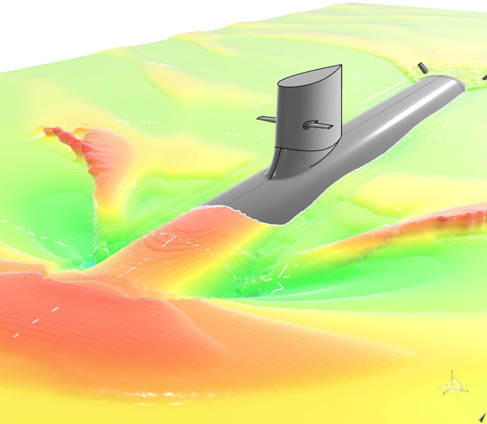

Once we have the geometry and control surfaces optimized, we can calculate the hydrodynamic wake of the submarine. We use the SIMULIA Fluid Dynamics Engineer, which takes advantage of a state-of-the-art unstructured second order fully implicit finite-volume Reynolds-Averaged Navier-Stokes (RANS) solver to model the flow, including turbulence. The interface between water and air, where the surface wake forms, is solved using the multiphase Volume of Fluid (VOF) formulation. The free surface VOF iso-contour plots are the data we need for the next stage of the simulation. Figure 3 shows an example from the semi-submerged submarine.
Any flow simulation requires careful meshing, as this affects both convergence behavior – which determines the speed of the simulation – and the accuracy of the results. Under MODSIM, meshing is a largely automated process.
Figure 3: Zoom of the free surface elevation for an inflow speed of 14kn (Fr = 0.23). Color indicates height variation

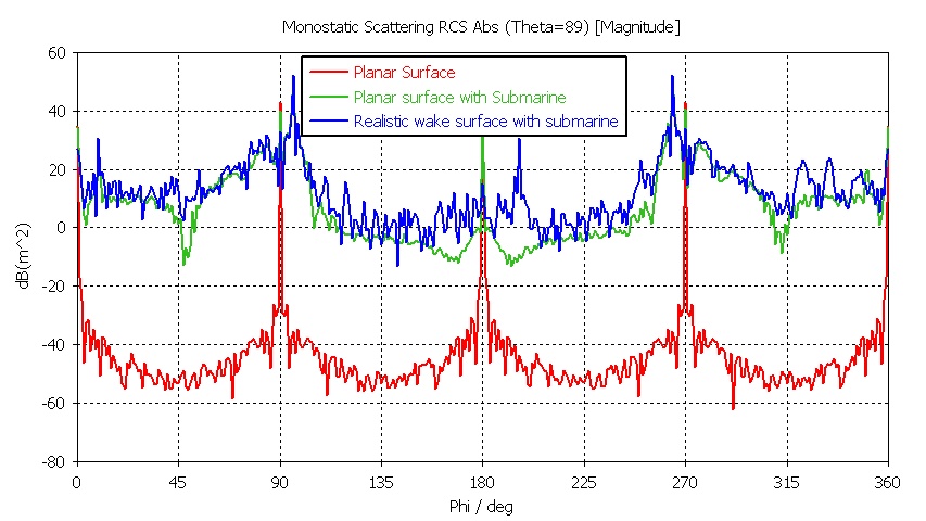

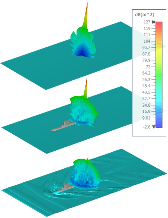

To calculate the RCS, a monostatic scattering simulation is carried out along the azimuth angle from 0 to 360 degrees, with a 1 degree step width at a fixed elevation angle of 89 degrees (almost sea level). In other words, the radar scattering is calculated at each azimuth angle around the sweep, and plotted in 1D around the target.
In order to extract the impact of the shape of the water surface, the simulation is repeated for a flat plane. The RCS in each simulation is compared to this one as a control. Figures 4 and 5 shows how the presence of the submarine and the waves affect the RCS – a full 3D far-field has been plotted here for illustrative purposes.
Figure 4: 3D far-field of the RCS of a reference rectangular plane (top), a rectangular plane with the submarine (middle) and the VOF with the submarine (bottom)
Figure 5: Rectangular RCS plot of the planar surface (red), planar surface with submarine (green) and realistic wake surface with submarine (blue)
The results show that the submarine has a significant contribution to the overall RCS.  The sub on a planar surface and a realistic surface has a very similar RCS, with the realistic surface dominating the planar surface at some angles. These angles are of interest, as they tell us the directions at which the excitation rays reflect off the surface of a wake, thereby compromising the stealth of the submarine.

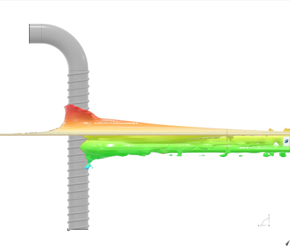

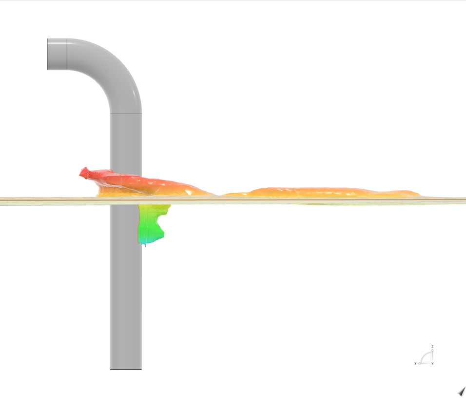

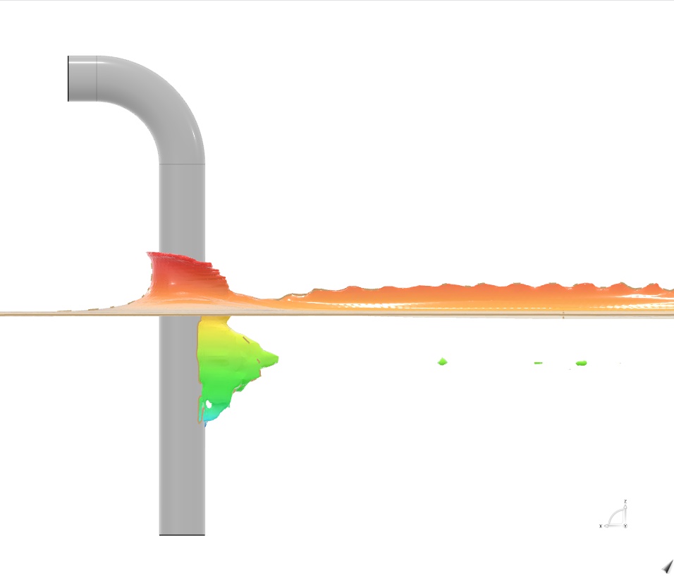

Conventional submarines use periscopes and snorkeling masts as vertical appendages to approach and breach the free surface. This means that these are a major source of hydrodynamic disturbance and turbulence. This results in an unsteady flow and a high, steep bow wave at snorkeling speeds below 5 m/s. This wave can be identified by radar or visual observation. To address this issue, baffles are added to the periscope – in this case, a helical strake running up the periscope disrupts the development of the bow wave (Figure 6). The strake model is parameterized so the thickness and pitch of the helix can be varied for a component optimization study.
Figure 6: Side-view of the free surface elevation for the (top left) isolated periscope at Fr = 1.3, (top right) isolated periscope at Fr = 1.8, (bottom left) periscope with 150 mm helical strakes at Fr = 1.8, (bottom right) periscope with 300 mm helical strakes at Fr = 1.8

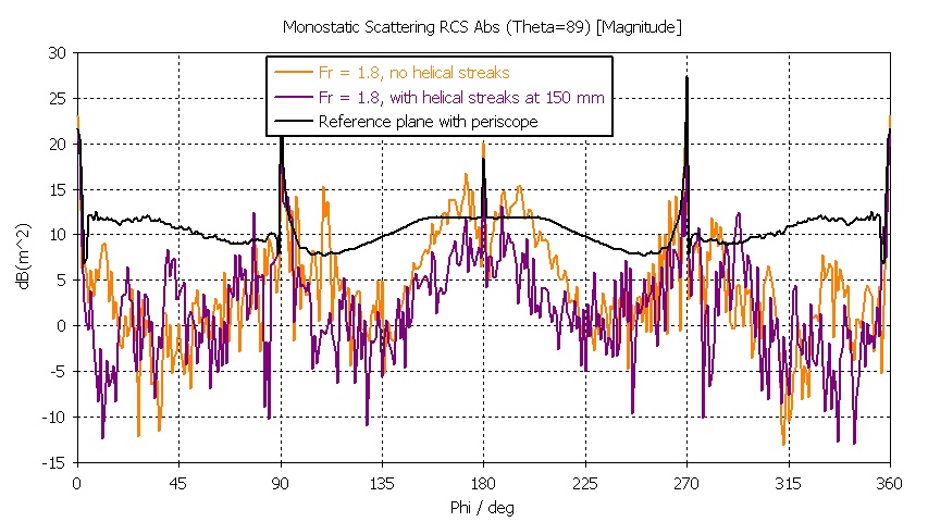

Figure 7: Comparison of RCS with and without helical strakes, showing significant reductions with the strakes.
The addition of helical strakes, especially at 150 mm, significantly reduced the overall RCS (Figure 7). Because a MODSIM methodology has been used, the optimized periscope design from the simulation can be easily returned to the model and integrated into the final submarine design.
