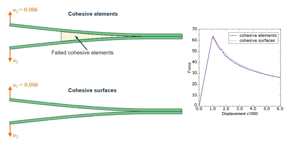

Ted also created a very handy parameterized version of a DCB specimen.  In this model, the geometry is made parametric so that the model can be quickly and easily changed to various specimen geometries.
The attached zip file contains the parametric Abaqus .inp file and Ted's 2005 & 2006 AUC papers.
Warning:  Because of the max time increment specified, this model will use close to 16,000 increments and run for ~3hrs. I suggest raising the max time increment before running.
