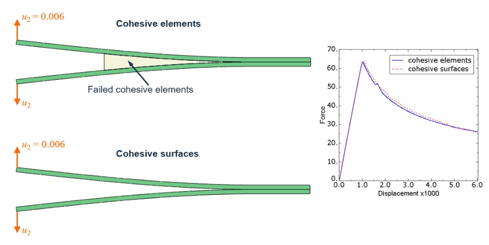

I really like the DCB specimen provided in Workshop 4 of the Composites class.  This is because by being a training class workshop, the Abaqus model is explained and documented well.   This is a 2D model, using CPE4I plane strain elements for the beams and COH2D4 cohesive elements to model the adhesive bonding the beams.  There are a total of 1880 elements: 1600 in the beams (arms) and 280 cohesive elements.

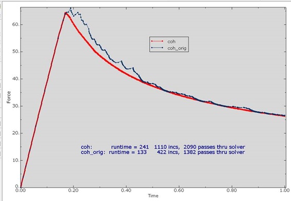

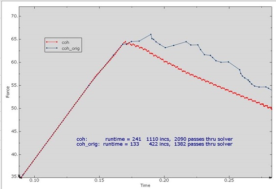

As is often the case for workshop models, this one is set up to run quite quickly.  This is also helpful when using the Calibration app in 3DX.   However, the original model shows a fairly coarse traction-separation result due to the coarse time-stepping and the viscosity value used.
coh_noparts_orig.inp
     0.01, 1., 1e-08, 1.0      runtime = 133 secs    422 incs, 1382 passes thru solver
coh_noparts.inp
    0.001, 1., 1e-08, .001  runtime = 241secs    1110 incs, 2090 passes thru solver
                     Same result, just zooming in near the peak force.
