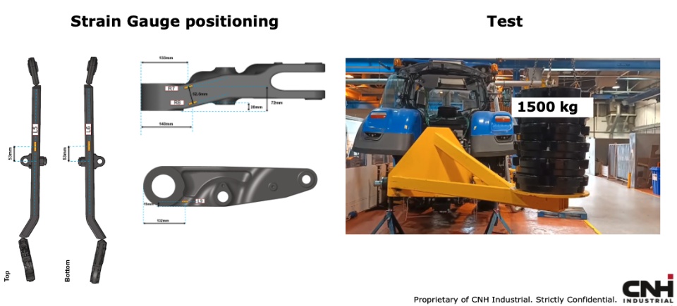

When farming equipment is used, the linkage system is exposed to various loads such as pulling, bending and torsion. These loads cause fatigue and damage to elements in the system. The present study is focused on introducing a new type of Finite Element Modeling of hydraulic cylinders, using Abaqus Fluid Cavity techniques to evaluate the behavior of the 3-point hitch when stressed by off-center loads due to mounted implements (e.g., rotary mowers or ploughs).
The hydraulic cylinders are modeled through a closed volume (associated to a Fluid Cavity) with a specific hydraulic law that links pressure variation to volume variation. This allowed to simulate the realistic pressure in the lift system and to determine the right stresses on the structure due to torsional load, confirmed by a numerical/experimental correlation.
