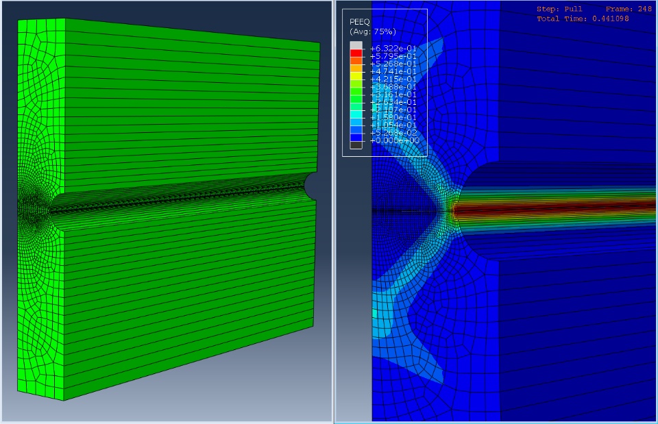

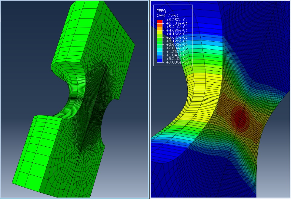

smR10 Specimen:  (round bar with 10mm radius circular notch)  In this specimen the TRIAX maximum is always at the center. The PEEQ maximum begins at the root of the notch but progresses to the center of the specimen as the deformation evolves.
In the model provided in this post, the center element is identified by:
          *Elset, elset=damage_location
           1335
For that element, at the end of the analysis we see
PEEQ = 0.652         TRIAX = 1.319     LODE = 1      (runtime = 30 secs)

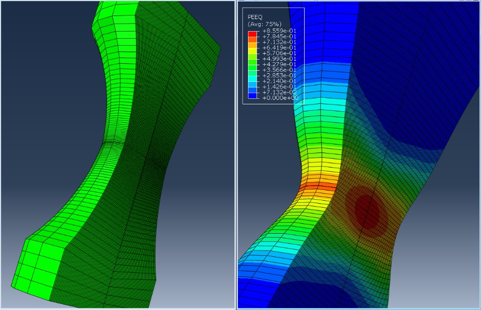

smR43 Specimen:   (round bar with 43mm radius circular notch)  In this specimen the TRIAX maximum is always at the center. The PEEQ maximum begins at the root of the notch but progresses to the center of the specimen as the deformation evolves.  The purpose of the different size notches is to vary the state of triaxiality.  Most metals will fail at a lower PEEQ as the TRIAX is higher.
          *Elset, elset=Center
            1804
PEEQ = 0.835         TRIAX = 1.148     LODE = 1      (runtime = 167 secs)

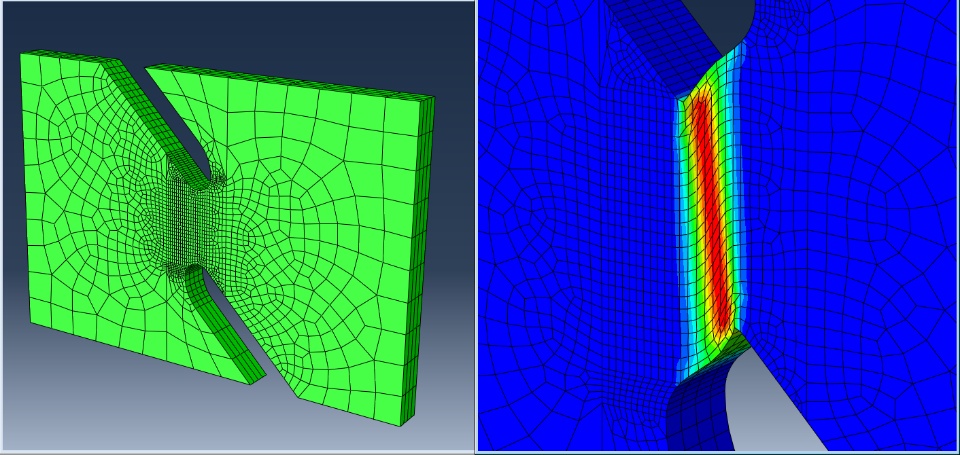

Shear Specimen:   This is sometimes called a rail shear specimen.  A shear band of peak PEEQ forms in the shear web.  The peak TRIAX is well away from the peak PEEQ.  The LODE angle peaks just outside this shear band, or at the edge of this band.  Element 3496 is chosen as the location of maximum PEEQ, thus the location where failure initiates.
In the model provided in this post, the damage location element is identified by:
       3496
PEEQ = 0.868         TRIAX = 0.354     LODE = 0.755      (runtime = 131 secs)

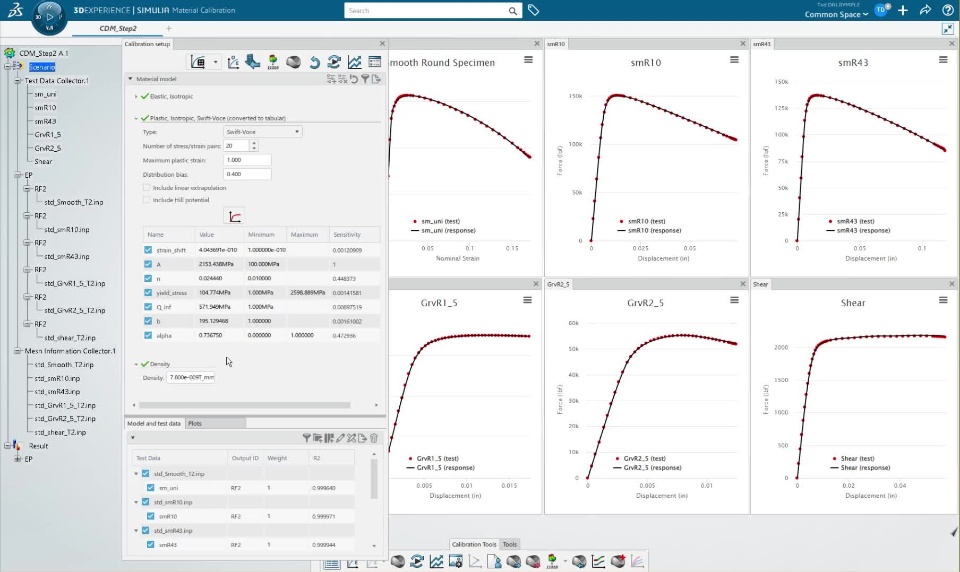

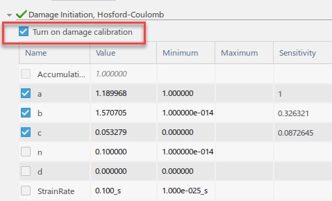

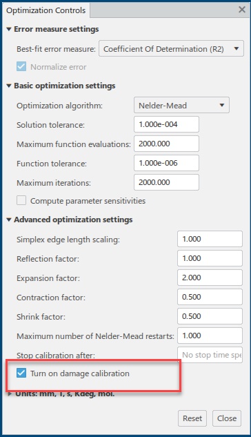

The process of determining the Hosford-Coulomb *damage initiation parameters is philosophically just determining the parameters that will fit a surface through the six different PEEQ, TRIAX, LODE data points that we listed above. We have built a special purpose feature for this in the calibration app. In R2022x, this special feature is invoked by using this checkbox under Optimization Controls :
In R2023x, FD01, we moved this selection to the material model, Calibration Setup area
A zip file is provided at the bottom of this post containing all the files needed to carry out a calibration as per this narrated video. This is a newer version of the video with better audio.  This video was created on 4-7-2023 using R2023x FD01 (HotFix 1.22)
This is the older version of the video created with R2022x, with poor audio quality (will delete this later).

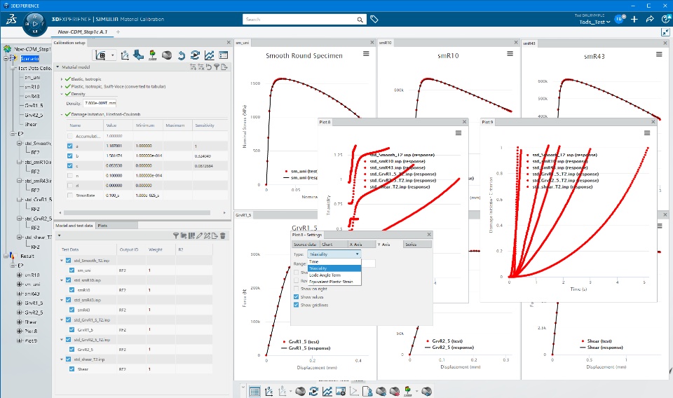

Here is an image at the end of the video. I should have mentioned that in Plot.8, which is plotted as Triaxiality (TRIAX) on the Y-axis, you could use the plot controls and change that to show the PEEQ or the LODE variable.
