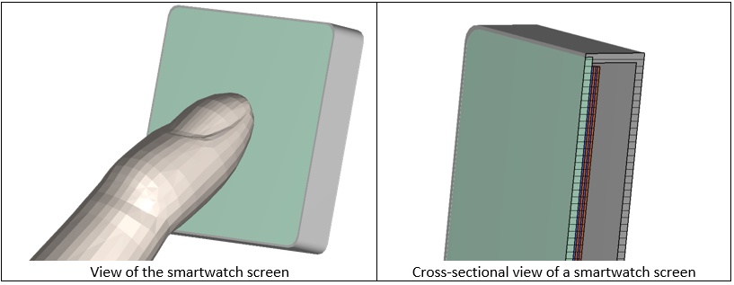

The smartwatch screen contains various different layers, which provide strength and act as the medium for displaying the information. The screen assembly is housed in a case and the sensors lie behind the layers of the screen.

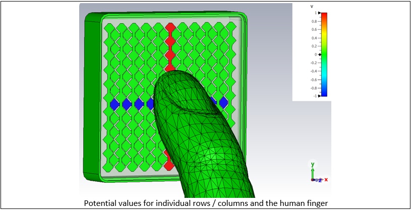

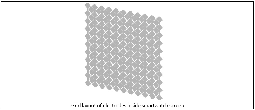

The sensor array is laid out in a grid and consists of rows and columns of electrodes, which can be controlled independently.
A known capacitance exists between each row and column in a grid. When a human finger approaches the grid, the capacitance of these rows and columns changes.

The individual rows and columns of the grid are excited sequentially at small intervals.

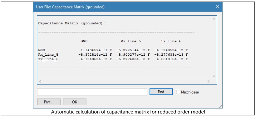

The software automatically calculates the capacitance between the rows and columns at different potentials and the ground using a series of electrostatic analyses. The resulting capacitance matrix fully characterizes the electrostatic behavior of the grid and can be used as a reduced-order representation of the FE model during circuit simulations.

CST Studio Suite offers a library of human models, including models of human fingers. The import and placement of these models into the model of the smartwatch is straightforward. Normally, the finger potential is the same as ground. The effect of the finger on the electric field distribution and the capacitance matrix can be incorporated in the model.

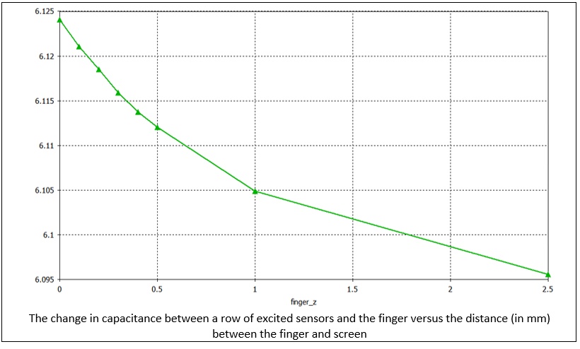

A parametric study has been performed for eight different positions of the finger, at varying distances from the surface of the screen (see image below). The change in capacitance for individual parts of the sensor grid is calculated. This calculation defines a sensitivity range for detection. As expected, the effect of the change in capacity is highest when the finger is closest to the screen and its effect diminishes as the distance increases.

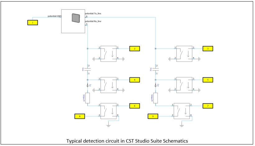

Each row and column of the sensor grid connects to a voltage-controlled switch, allowing for the sequential excitation of the entire grid many times per second. The optimization of the circuit components ensures the fastest possible response time from the sensor array which corresponds to a real-time feel for the user to the movements of their finger.

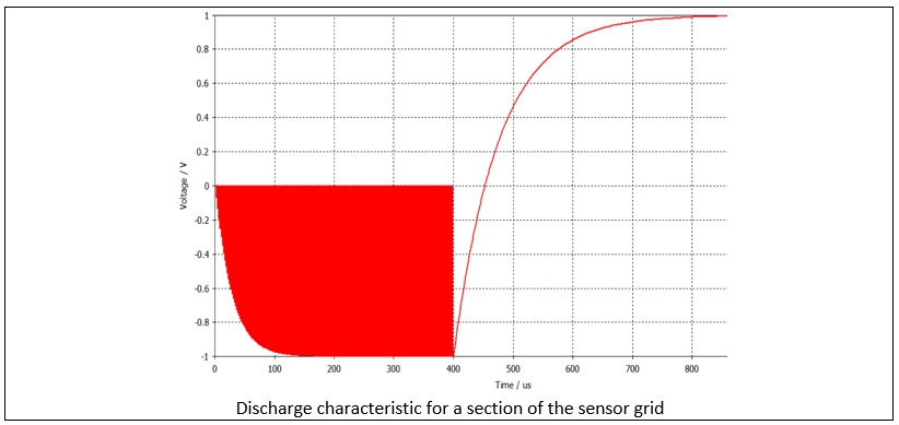

The response of the circuit is measured by the voltage drop across the circuit components. The faster the voltage drop, the quicker the detection of the finger position and the better the temporal resolution of the sensor. In the image below, we can see the voltage characteristic at the position of the probe P1. The circuit is charging for a given amount of time, after which the connection to the supply is interrupted and the circuit is allowed to discharge. The detection is done at the zero-crossing point of the probe signal.
The CST Studio Suite Schematic tool allows for rapid circuit simulations that include the representation of the smartwatch and finger finite element (FE) model by their equivalent capacitance matrix, previously calculated from a series of FE solutions for different finger positions.

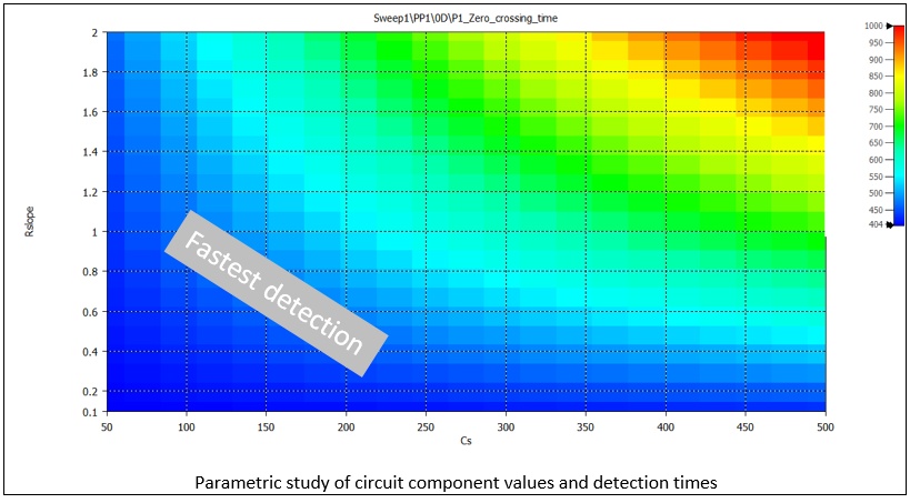

Very fast optimization studies can be performed to optimize the values of different circuit components (for example resistors and capacitors) to obtain the fastest detection time. The optimization can be performed in a matter of seconds or minutes, as it does not require rerunning of any new finite element solutions.
