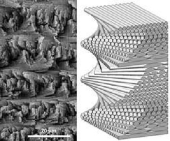

Photo (left) and computer model (right) of the helicoidal structure in a mantis shrimp. Image courtesy of Professor Pablo Zavattieri, Multi-Scale Mechanics and Materials by Design Laboratory, Lyles School of Civil Engineering, Purdue University.
Zavattieri uses Abaqus to perform structural simulation to investigate hypotheses involving biological materials inspired by these and other creatures. The mantis shrimp, for example, has extremely strong, tough, and fast-moving club-like front limbs that it uses to pummel prey or attackers. These clubs are formed with a helicoidal or “Bouligand” structure, which includes slightly twisted layers consisting of multiple fibrils in a mineral matrix. Each fibril is made up of multiple proteins.
Zavattieri and his lab use multi-scale simulation to capture the behavior of the materials at each level and to study why the structure is so strong, as well as how cracks propagate through the surface. They can then 3D print composites with the same structure and conduct experiments to verify the failure mode identified by the simulation and the best selection of synthetic materials to substitute for the biological minerals and proteins.
The mantis shrimp’s helicoidal architecture is currently being applied to carbon- and glass-fiber reinforced composites. Zavattieri and his lab are also working on the 3D printing of cement using the types of architectures found in mantis shrimp, lobsters and crabs, and are seeing an increase in toughness.
