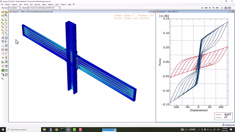

Behavior Analysis of Post-Tensioned (PT) and Non-Post-Tensioned Steel Beam-Column Connections Under Cyclic Loading
Posttensioned (PT) steel beam-column connections have a history of providing acceptable stiffness, strength, and ductility while avoiding permanent deformations in moment-resisting frames subjected to seismic loads🏗️⚙️. This study verified and analyses complete three-dimensional finite element (FE) models of steel beam-column connections with PT strands under cyclic loading.🌟🔍
