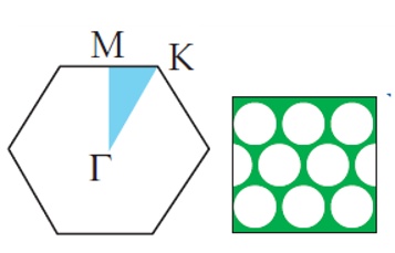

For example, the two dimensional hexagonal lattice below would be completely covered in terms of Eigen mode calculation if we sweep the wave vectors from 𝜞--> K--> M-->𝜞
Figure. 1: Wigner–Seitz cell and irreducible Brillouin zone of a 2D hexagonal lattice

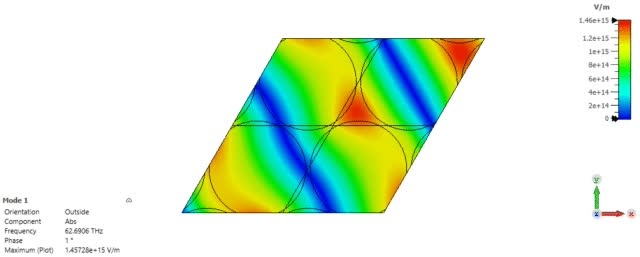

Through this feature, the dispersion diagram of the hexagonal structures shown in below could be calculated without any tedious post-processing steps.
Figure. 3:  the hexagonal lattice simulated in CST Eigen mode solver and the corresponding phase shift of UnitCell boundary condition

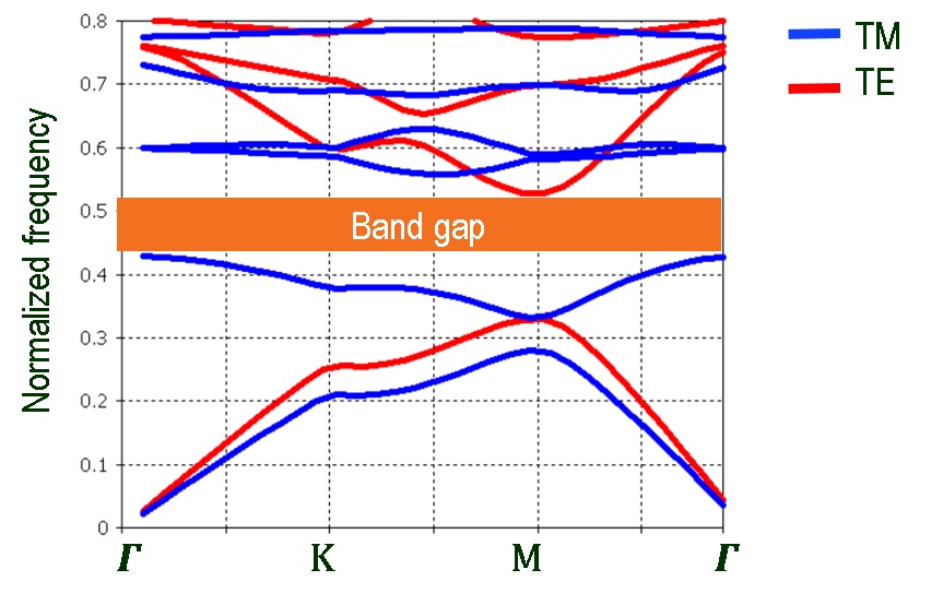

The phase shifts are swept in a single parameter sweep procedure so that the desired wave vector path (𝜞--> K--> M-->𝜞) have been fully covered. The figure. 4 depicts the dispersion diagram. It can be noted that the there is an area in which no Eigen frequencies have been found in the whole range of Bloch wave vector. It simply means that no electromagnetic field is permitted in that frequency range and thus it is commonly called as the band gap.
Figure. 4: Dispersion diagram and the band gap of the hexagonal lattices
