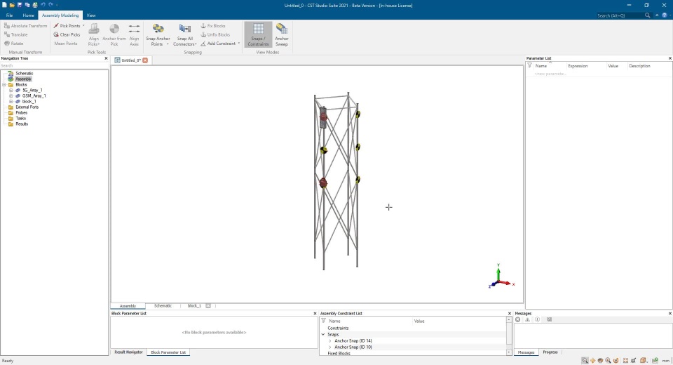

Antenna Array Placement using the System Assembly Modelling
The System Assembly Modeling in CST Studio Suite is a great way to quickly place antennas (i.e. the complete simulation project) unto a platform or in the environment where it is intended to operate. The performance in terms of radiated fields and antenna-to-antenna coupling can then be evaluated using the Hybrid Solver task, which automatically sets up the appropriate simulation domains based on the assembled model.
Below is a short video of Antenna Arrays showcasing some of the newer features with the System Assembly Modeling. For more details about the workflow please refer to the linked application note which also includes some example models.
