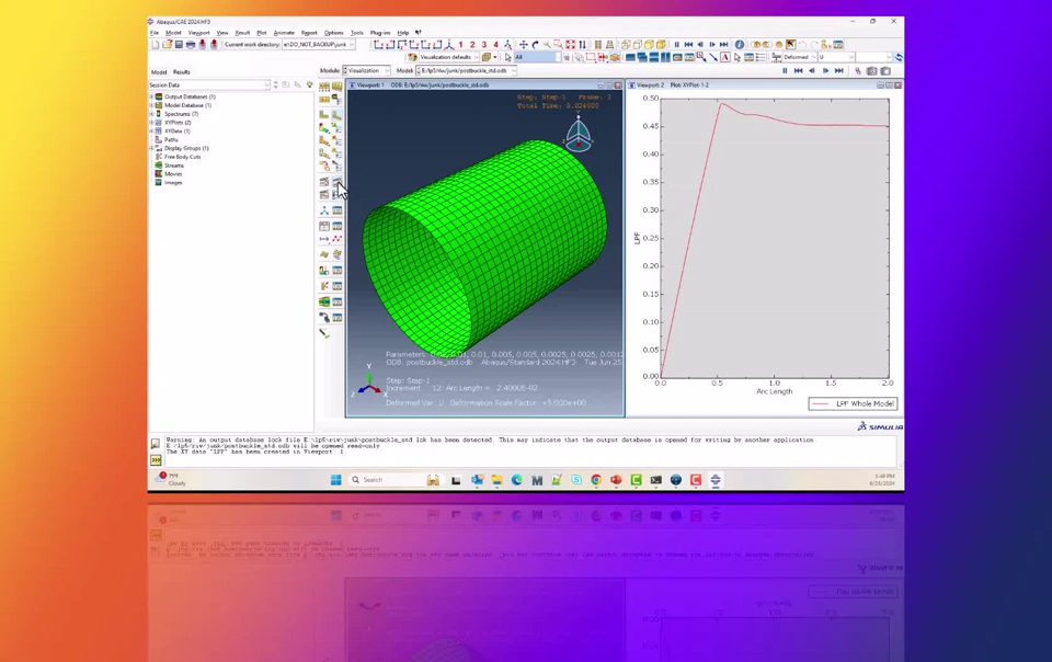

Animating LPF for RIKS
This video shows how to animate the load proportionality factor (LPF) alongside the deformed structure from a RIKS simulation in Abaqus/Standard. Please refer to the documentation at help.3ds.com to learn about the RIKS method and how it can be used to study the post-buckling behavior of structures.
