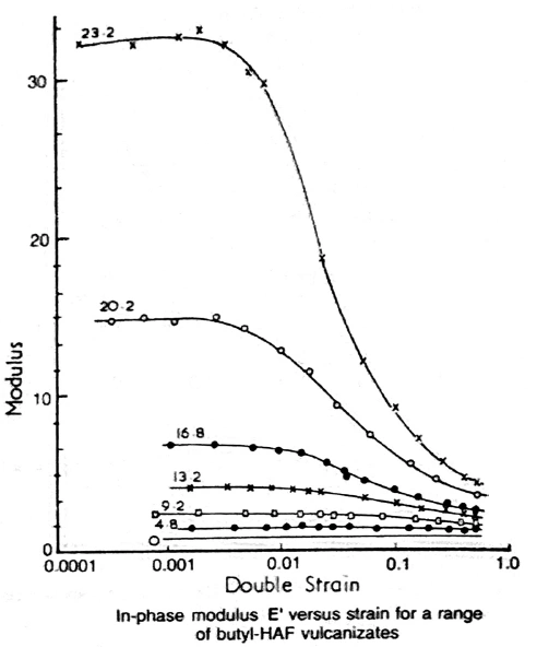

Abaqus can capture many of these responses, but there is one rubber response that has presented a challenge – the Payne effect (or perhaps more correctly the Fletcher-Gent effect). Classic linear viscoelasticity allows for a storage and loss modulus that are functions of frequency, a common requirement. But, the experimental tests of Payne on carbon black (Carbon black is commonly used in rubbers to increase volume, strength and vulcanization) filled rubbers demonstrated that the viscoelastic response, that controls the storage and loss modulus, is also a function of strain amplitude. Payne's results are shown below
A demonstration of the Payne effect from Gent and Scott, Engineering with Rubber - How to Design Rubber Components

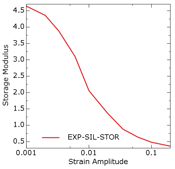

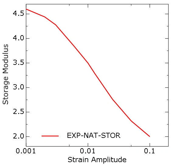

The images below shows the storage and loss modulus for two rubber compounds, a natural rubber with 75 phr (parts per hundred) carbon black filler and a silica filled silicone rubber. The experimental data in the plots comes from the work of Chazeau et al, 2000: Modulus Recovery Kinetics and Other Insights into the Payne Effect for Filled Elastomers (Polymer Composites, vol21, No 2).
Natural Rubber
Silicon Rubber

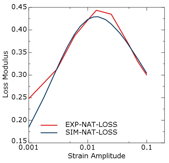

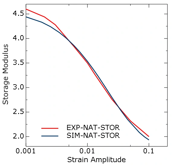

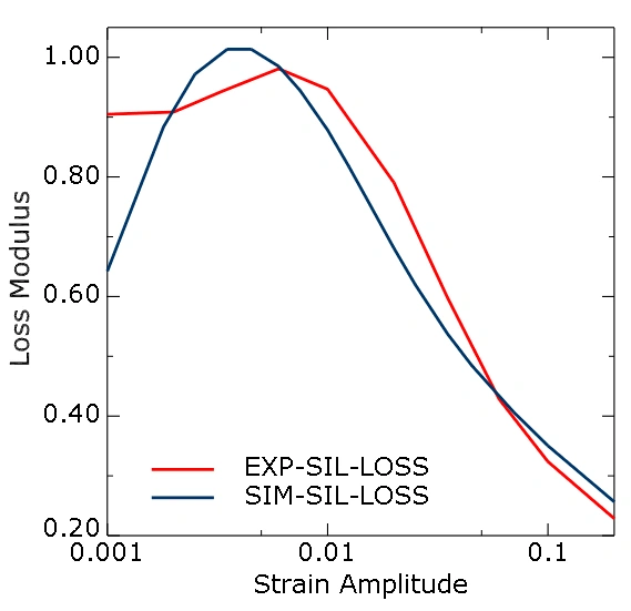

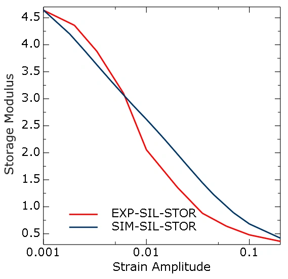

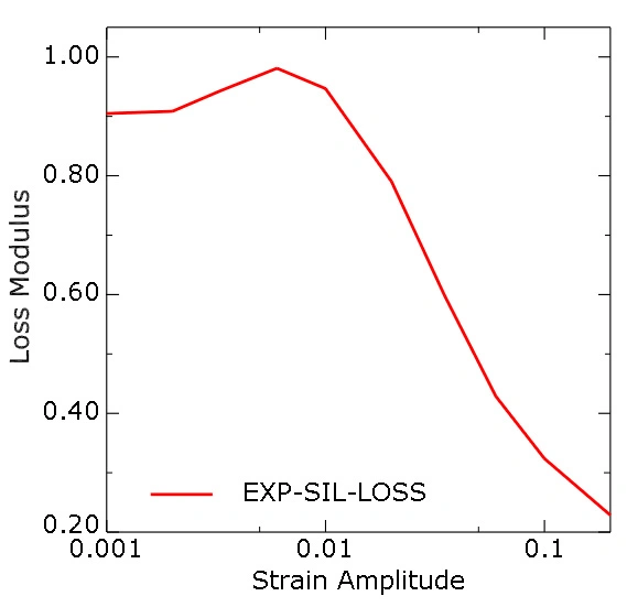

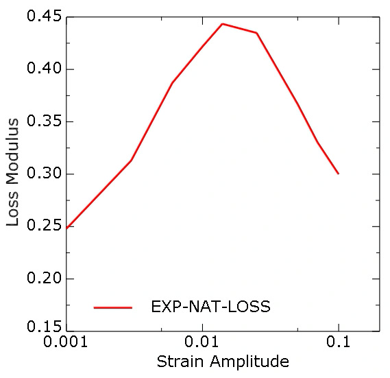

This was implemented within a user subroutine, and then a traditional Isight workflow was used to determine suitable material constants. The images below show the match between the energy based DBB model and the experimental data for natural and silicon rubbers
Silicon Rubber
A comparison of the storage and loss modulus predicted by this new material model and the experimental data for silicon rubber
Natural Rubber
A comparison of the storage and loss modulus predicted by this new material model and the experimental data for natural rubber
