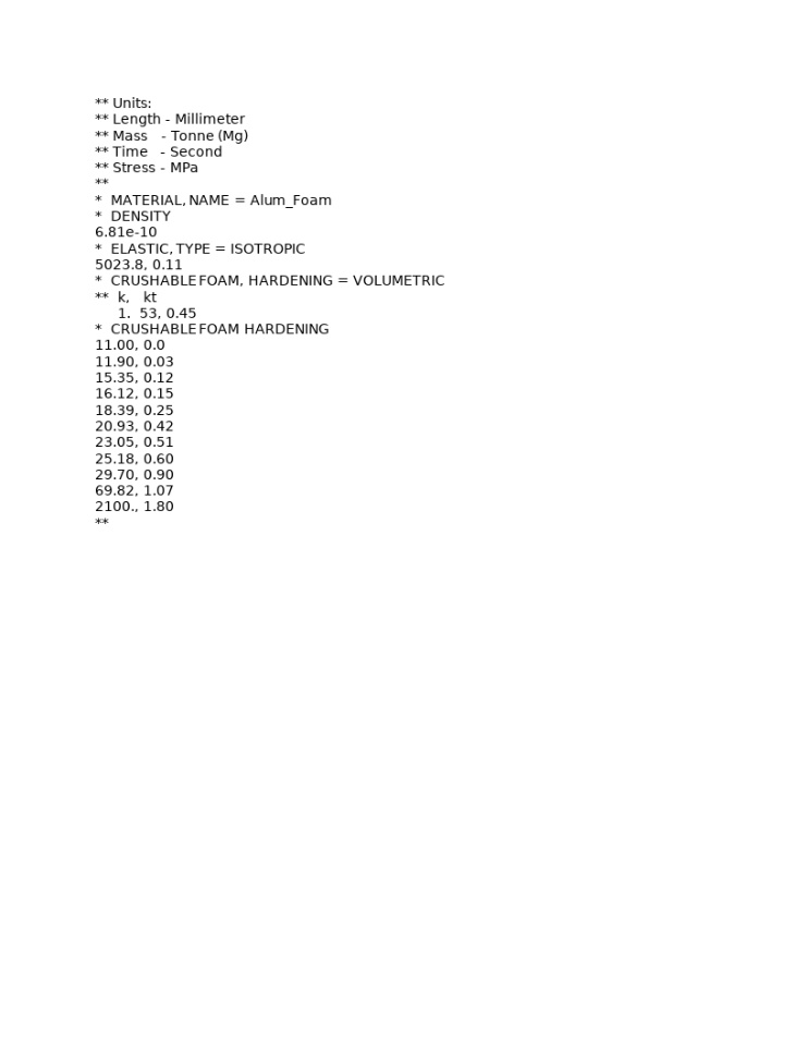

This article by Novak, et al, has a detailed set of Abaqus crushable foam parameters:
Compressive Behaviour of Closed-Cell Aluminium Foam at Different Strain Rates
Materials 2019, 12, 4108; doi:10.3390/ma12244108
This is the quasi-static crushable material model definition extracted from the paper:
