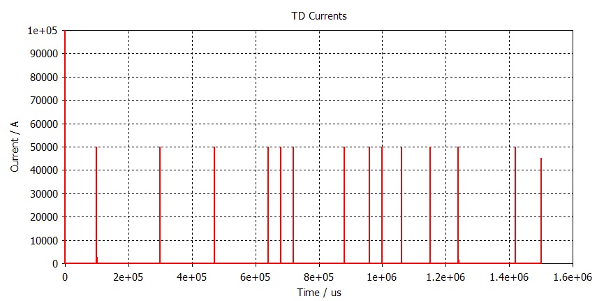

Multiple Stroke Pulse Pattern

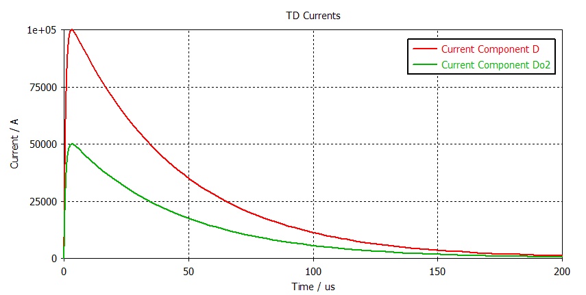

The multiple stroke pulse pattern in Fig. 1 is composed of randomly spaced current components D and D/2 shown in Fig.2 and last for 1.5 seconds.
Fig. 1: Multiple stroke pulse pattern.
Fig. 2: Current components D and D/2.

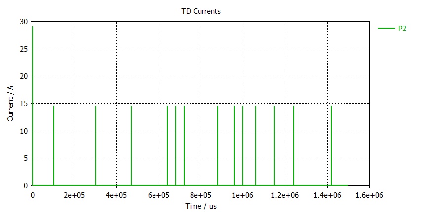

The circuit simulation, including vector fitting but excluding the 3D electromagnetic simulation, of the aircraft model, described in my post Aircraft Lightning Electromagnetic Pulse Simulation I,  took only about 72 seconds on a laptop computer to reach the cable pin current output in Fig. 3.
Fig. 3: Cable pin current.

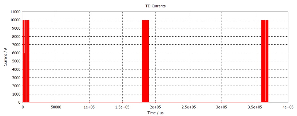

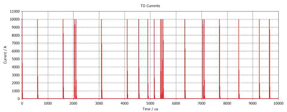

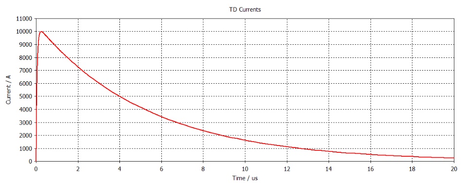

The multiple burst sequence in Fig. 4 is composed of three randomly spaced bursts. Each burst in Fig. 5 consists of 20 randomly spaced current components H in Fig. 6. Multiple burst sequences last for up to 620 ms and each burst for up to 20 ms.
Fig. 4: Multiple burst sequence.
Fig. 5: One burst of 20 H pulses.
Fig. 6: Current component H.

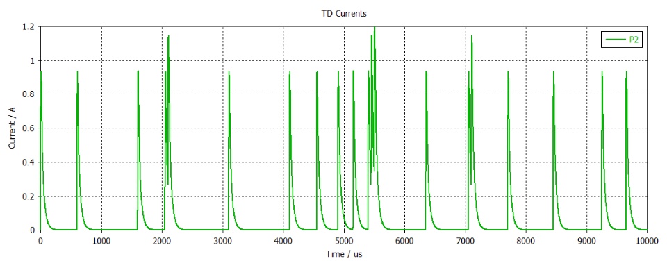

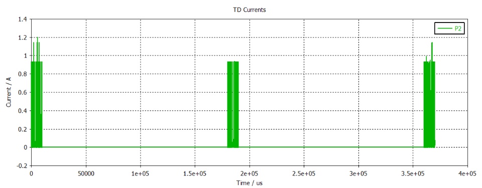

The circuit simulation, including vector fitting but excluding the 3D electromagnetic simulation, of the aircraft model, described in my post Aircraft Lightning Electromagnetic Pulse Simulation I,  took only about 17 minutes on a laptop computer to reach the cable pin current output in Fig. 7 and Fig.8, respectively.
Fig. 7: Cable pin current of multiple burst sequence.
Fig. 8: Cable pin current of one burst.
From Fig. 8 it's the effect of closely space H pulse becomes visible in terms of increased amplitudes due to superimposed pulses.
