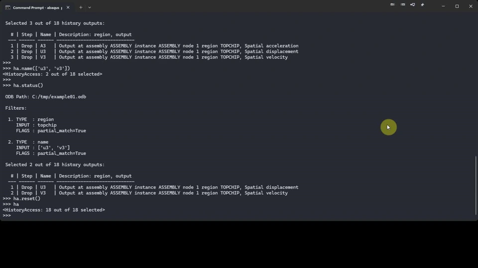

# Open the ODB file and create the HistoryAccess object.
odb = odbAccess.openOdb(path=r'C:/temp/Circuit.odb', readOnly=True)
ha = HistoryAccess(odb)
# Extract the "MISES" output for element "637" in the "PACKAGING-1" instance.
ha.name('MISES').instance('PACKAGING-1').element(637).fetch()
The last line of code is all that is needed to search the database and extract the required history output. Note that the returned object contains additional metadata beyond the X and Y values, allowing for further processing if necessary.
The module currently offers 10 different filters (e.g., name, step, region) and includes auxiliary functions to assist with plotting, exporting, and post-processing.
Additional details about the methods and usage examples are available in the ReadMe file included with the module, as well as in the video tutorial provided below.
