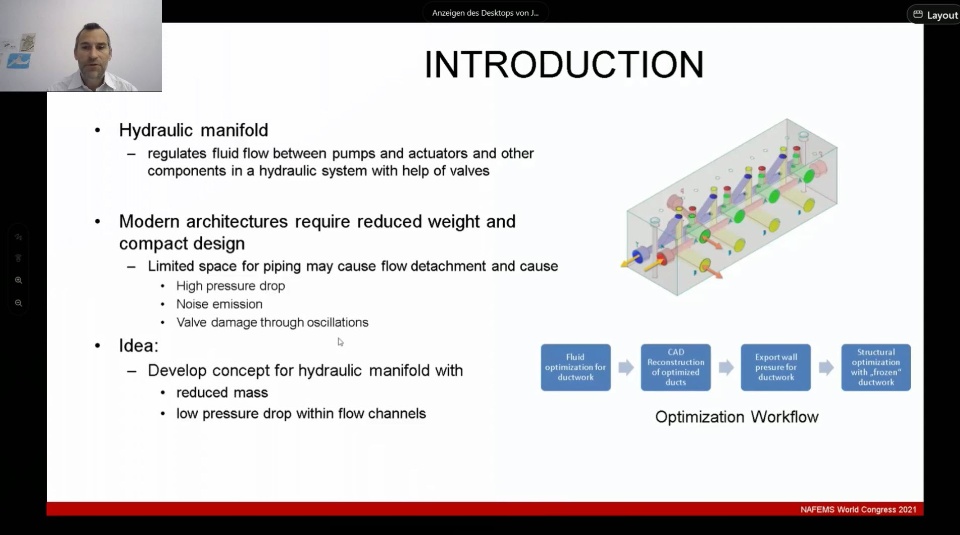

Within this paper, a topology optimization tool will be presented which fulfills the above-mentioned requirements. The potential of the tool will be demonstrated by going through an optimization task for a hydraulic manifold block. Hydraulic manifolds are applied to regulate fluid flow between pumps and actuators and other components. They are often exposed to high fluid pressures resulting in a highly loaded structure. Therefore, a conservative concept is usually taken leading to a significant weight of the manifold part. The goal of this task is to provide a lighter design concept with improved flow behavior. In a first step, a flow topology optimization is done, which provides an improved ductwork at low pressure drop and without recirculation. After that, a structure topology optimization of the surrounding solid is applied within the same working environment to minimize the mass for given constraints. For this step, the fluid pressure distribution along the optimized duct walls is taken as load condition. The outcome of this twostep procedure is a design with a significant reduction in weight and pressure drop.
