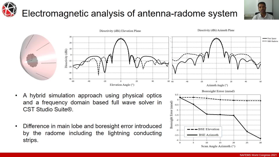

A hybrid simulation approach is utilized in order to model the electromagnetic interaction between the antenna system and the radome based on a 3D full-wave analysis technique as well as Physical Optics. To validate the design approach a multi-layered sandwich radome protecting a weather radar antenna operating at X-band (9.3 GHz) is studied. The antenna and the radome are situated at the nose of a regional jet type commercial aircraft. A slotted waveguide antenna array is used to achieve the scanning behavior. The aerodynamic forces on the radome surface were computed at typical cruise flight conditions to provide the input for calculating the resulting stress under the aerodynamic loading. The thickness and the stacking sequences of the different layers of the radome are optimized with the objective to maximize the transmission coefficient subjected to the constraining buckling safety factor. Additionally, the maximum structural damage in the event of a high-velocity bird impact is simulated to ensure that no loss of structural integrity of the radome occurs with the optimal design parameters. The lighting protection strips on the radome have also been included in the study to investigate the impact of the solid and segmented strips on the radiation performance of the antenna.
The model-based engineering approach offers an efficient workflow to automate the multiphysics analysis of the radome resulting in optimal designs for electromagnetic and mechanical performance of radomes. This approach enables early-stage design validation of radomes and accurate prediction of antenna behavior with the radome, thus reducing the amount for physical prototyping and therefore design costs.
