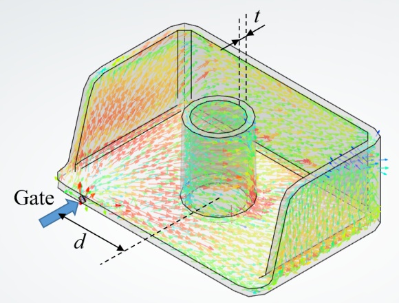

In this study, we extended this workflow to design of experiments to explore design alternatives. Using a plastic mounting boss as an example, the effects of the part thickness and injection gate location on the maximum von Mises stress in service have been studied. An optimal design has been obtained by minimizing the stress and weight together.
Design parameters (d=gate location offset, t=thickness) and plastic injection simulation result (arrows indicate fiber orientation).

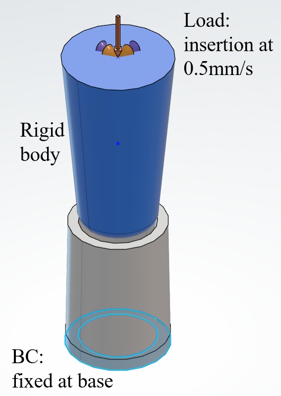

Structure simulation definitions

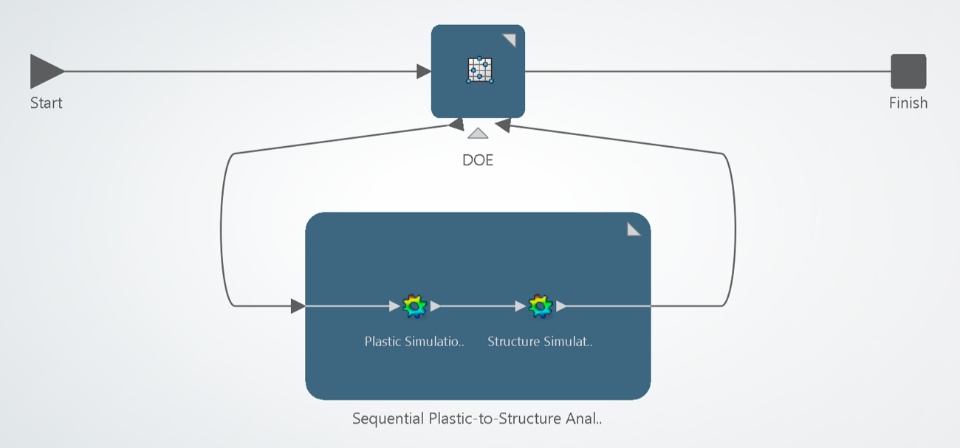

Simulation process for DOE analysis. The two gear icons represent the plastic injection simulation and structure simulation, respectively.
