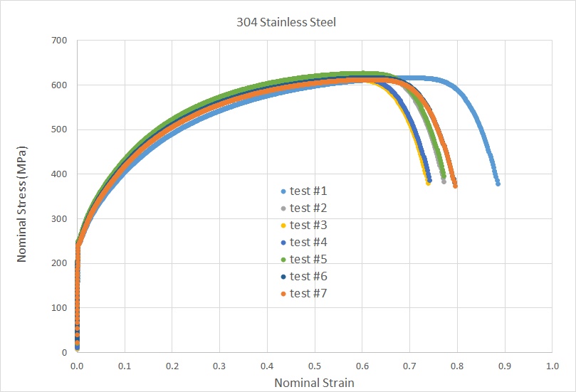

The image above shows 7 repeats of a uniaxial tension test performed on 304 Stainless steel.  This raw data is attached to this post in a zip file below.

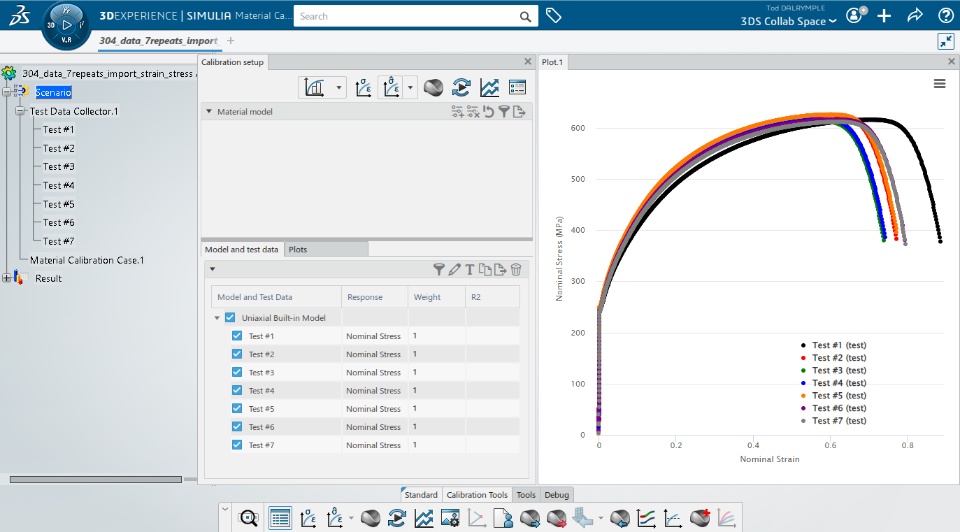

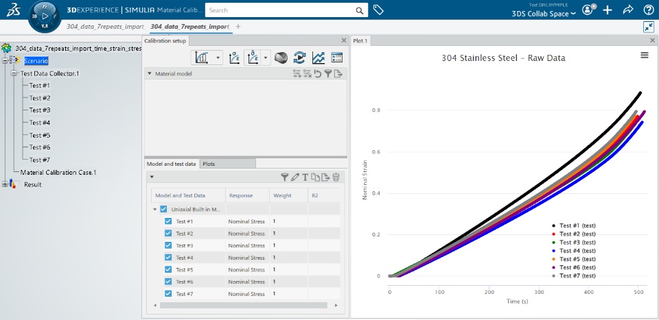

After importing all of the 7 datasets, my calibration object looks like this:

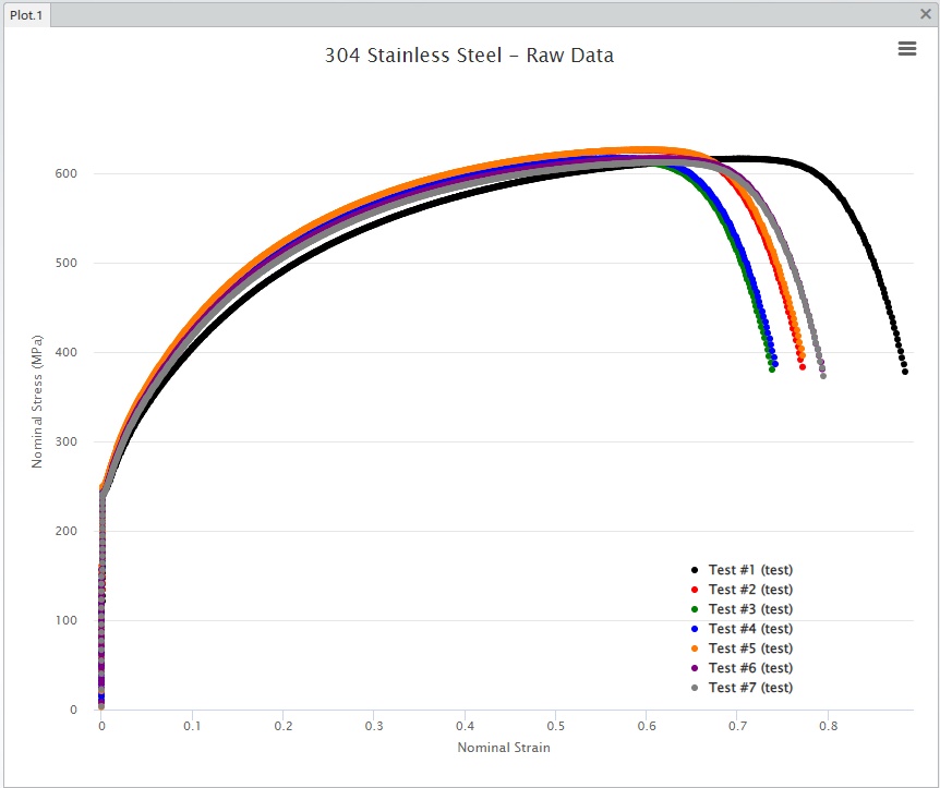

The data looks like this:

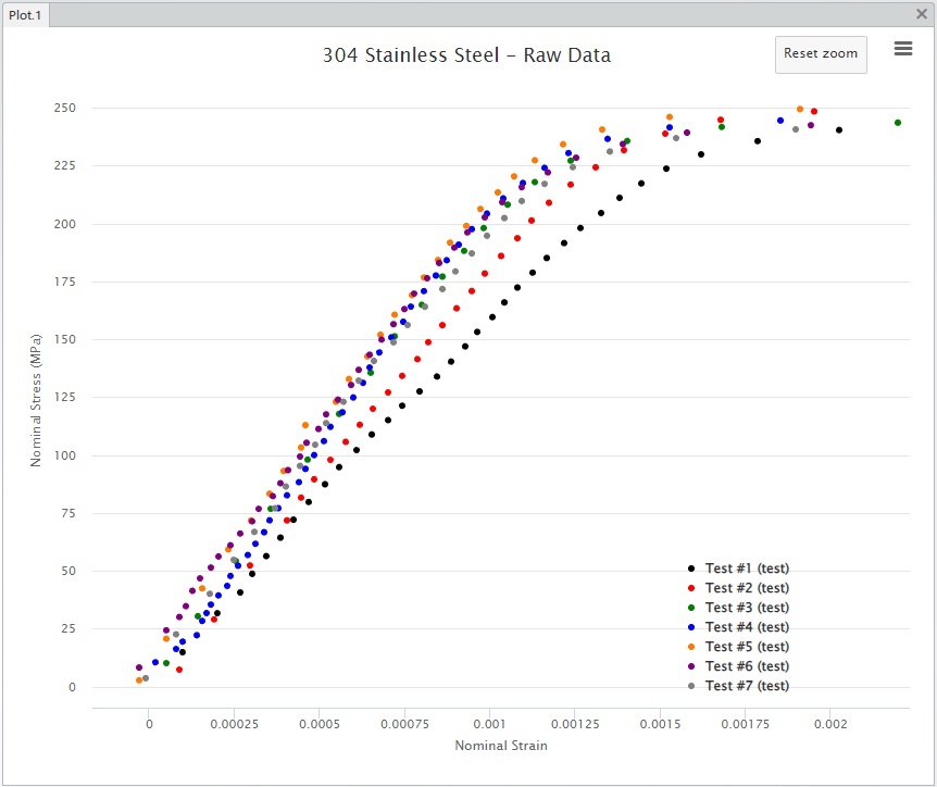

Zooming in to the linear range:

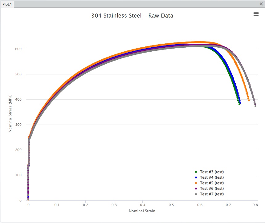

From the two images above, I can already begin assessing the quality of the 7 tests. All of the tests have some zero-shift issue, which we can correct in the app.  In the testing of metals we expect a pretty tight grouping of data in the linear elastic region, from image #2 we could conclude that test #1 and test #2 are of poorest quality and we should not use those tests.  We have a new feature that can "deactivate" a dataset.  After deactivating test 1 & 2, our test data looks like this:

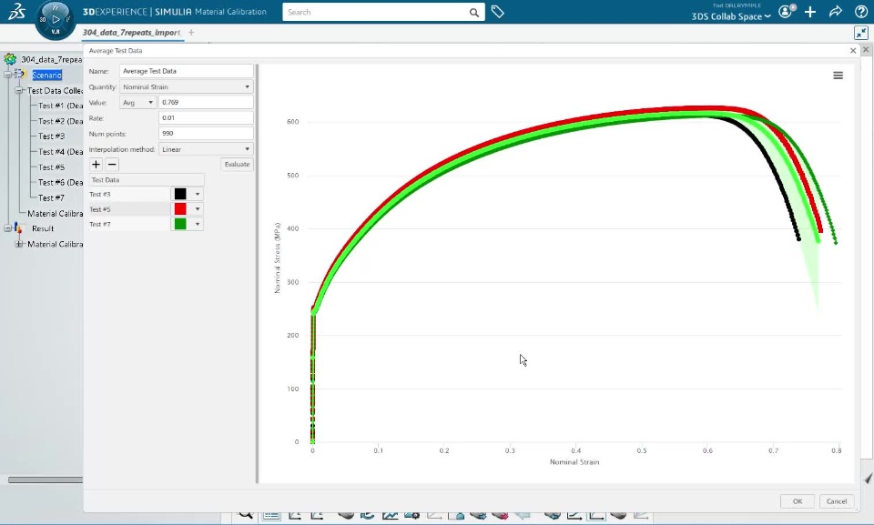

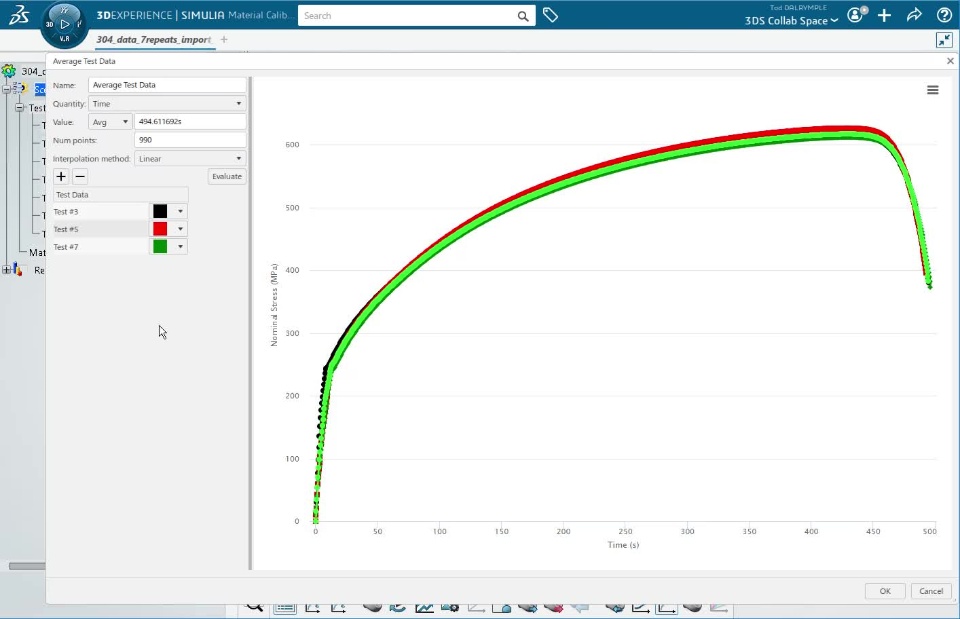

Tests 3 & 4 are very close to each other.  Tests 6 & 7 are very close to each other and test #5 is in between. After some further inspection, I chose to keep tests 3, 5 and 7.  Prior to averaging these 3 datasets, perform a zero-shift on each one.  The video below starts by using the 3dxml file named 304_data_7repeats_import_strain_stress_cleaned.3dxml

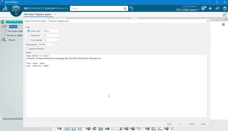

Import test data as
The import of the data is similar as before, except this time we select all 3 columns of test data .  This injects a bit more variability into the data.  The plot below shows the nominal strain versus time. The strain-rate for each dataset is no longer the same.  For metals, we do not expect that this small variation in strain-rate should effect the response physics, nor do we need to capture strain-rate as a material model parameter.
In the attached zip file there is a 3dxml file, named 304_data_7repeats_import_time_strain_stress.3dxml, that just contains the 7 datasets.
There is also a file in which datasets 3, 5, & 7 have been cleaned (zero-shifted):
304_data_7repeats_import_time_strain_stress_cleaned.3dxml
