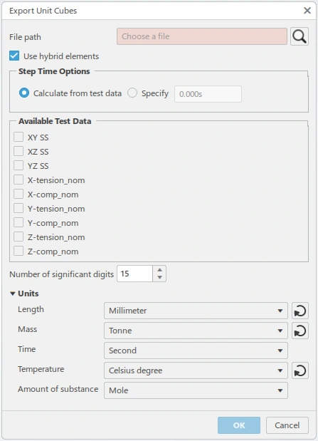

26x FD01 Calibration : Export Unit-Cube new feature
Access the "Export Unit Cube" new feature from the Action Bar :
After that, you will see the image at the top of this post.  This new feature is used to create an Abaqus FE model from Analytical or Numerical mode.  All of the "deformation modes" are supported and the exported unit cube model will have the appropriate BCs and loading conditions as stipulated by the test data. We have tried to make it so that these are "run-ready" FE models, but some controls may have to be tweaked.

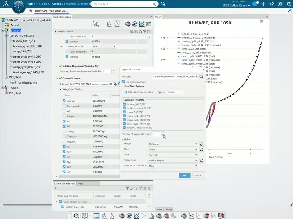

The video below shows how to use this new feature:
The video above was also shown in the context of a paperboard model calibration here:
 26x FD01 Calibration : New Paperboard model added
The Export Unit Cube new feature is also demonstrated (at about the 3minute mark) in the video in this post:
26x FD01 Calibration : Hencky hyperelasticity added
