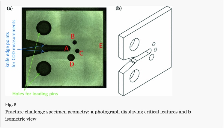

Sandia National Laboratory tested tensile specimens of 15-5 PH, a precipitation hardened martensitic stainless steel, and challenged a set of participants to predict the tearing force-displacement curve and the crack propagation pattern in a specially fabricated compact tension specimen. By "specially fabricated", it simply means that a special arrangement of a blunt notch "A", and circular holes, B, C, and D were fabricated in each specimen.

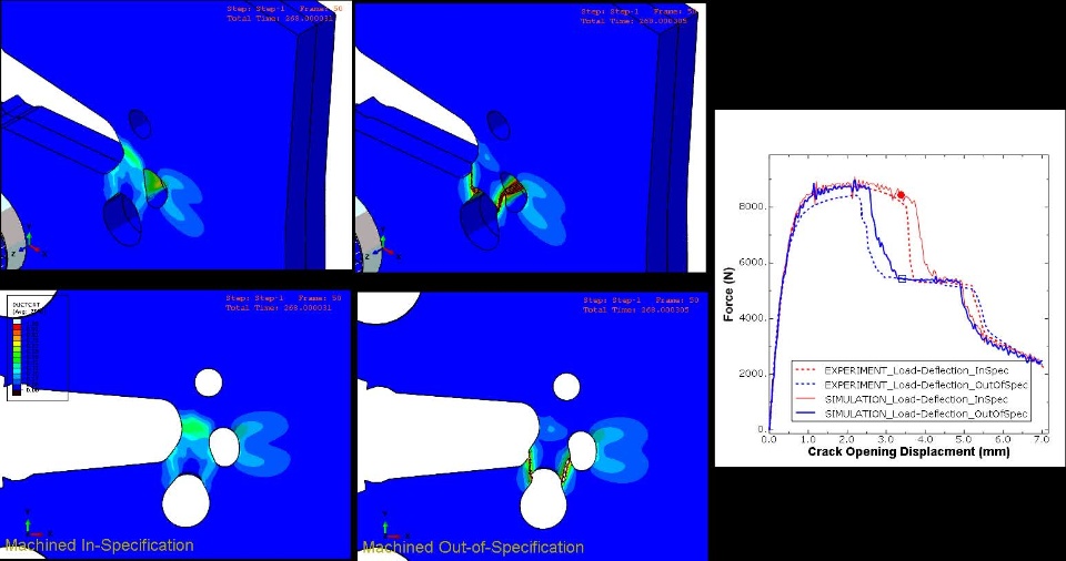

For example, here is a nice animation of the tearing simulation created by my colleague, Lance Hill:
Lance also provided the two Abaqus Explicit input files that were used to generate the animation above.  The Sandia report noted how different specimens had different tearing patterns, and Lance showed in these analyses that this was due to the machining differences from specimen to specimen.  The Sandia report spoke to this issue, that is, some specimens were "in-spec" and others were "out-of-spec" when compared to the original specifications of the specimen geometry.
