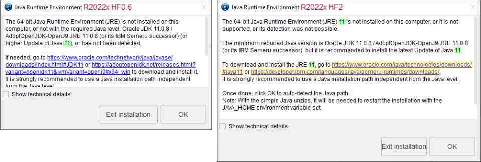

Spotlight 1: Java Runtime Environment Prompt
The first spotlight is on the Java Runtime Environment prompt which appears when installing SOLIDWORKS Connected. With the May 18th platform update:
  • The wording makes it clearer that JRE version 11 is required.
  • The links bring you closer to what you need.
Direct Link
Since the direct download links cannot be hard-coded, here is one of the supported version 11 installers:
<a href="https://github.com/ibmruntimes/semeru11-binaries/releases/download/jdk-11.0.13%2B8_openj9-0.29.0/ibm-semeru-open-jre_x64_windows_11.0.13_8_openj9-0.29.0.msi" rel="nofollow">https://github.com/ibmruntimes/semeru11-binaries/releases/download/jdk-11.0.13%2B8_openj9-0.29.0/ibm-semeru-open-jre_x64_windows_11.0.13_8_openj9-0.29.0.msi</a>
The improved prompt will be visible to new 3DEXPERIENCE SOLIDWORKS for Makers subscribers as well as existing scribers who are installing SOLIDWORKS Connected on another computer.
