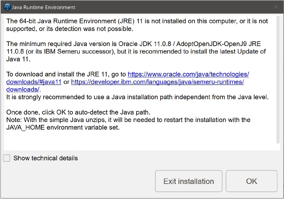

As you all aware about the "JAVA Runtime Environment" was one of the prerequisite to install SOLIDWORKS Connected or SOLIDWORKS Visualize Connected application for R2022x FD02 and previous versions. While installing these software, everyone used to get  "JAVA Runtime Environment" installation warning if "JDK/JRE 11.0.8" was not installed previously as mentioned in [Enhancements for MAKERS] Java Runtime Environment Prompt post.
