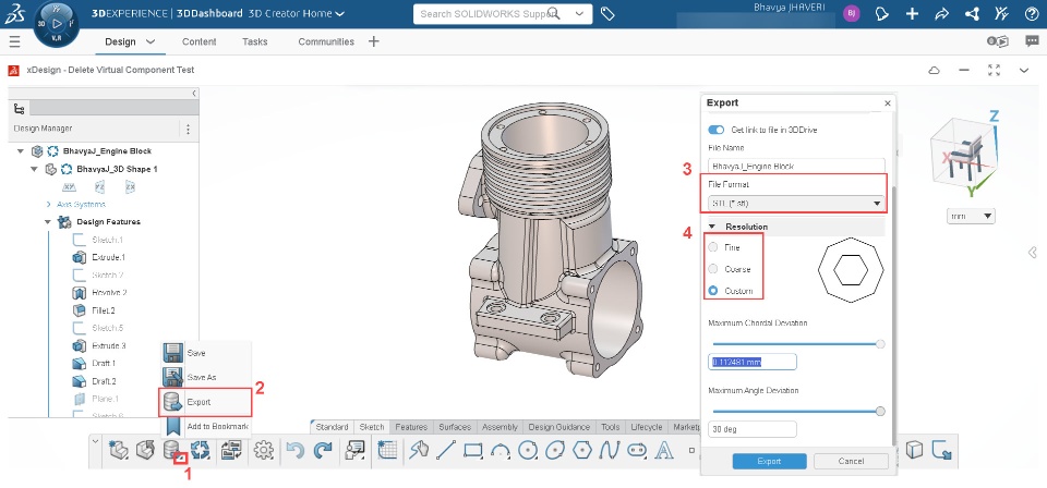

With the release of R2024xGA, when exporting your file as STL or 3MF formats you’ve got the power to define the model resolution with three new settings:
  • Fine: For those intricate details in your designs.
  • Coarse: For a quick export with a bit of a rough-and-ready charm.
  • Custom: Tailor the size and output quality to match your exact needs.
✨These settings give you better control when exporting designs for 3D printing!
The image below shows the steps for exporting your files:
