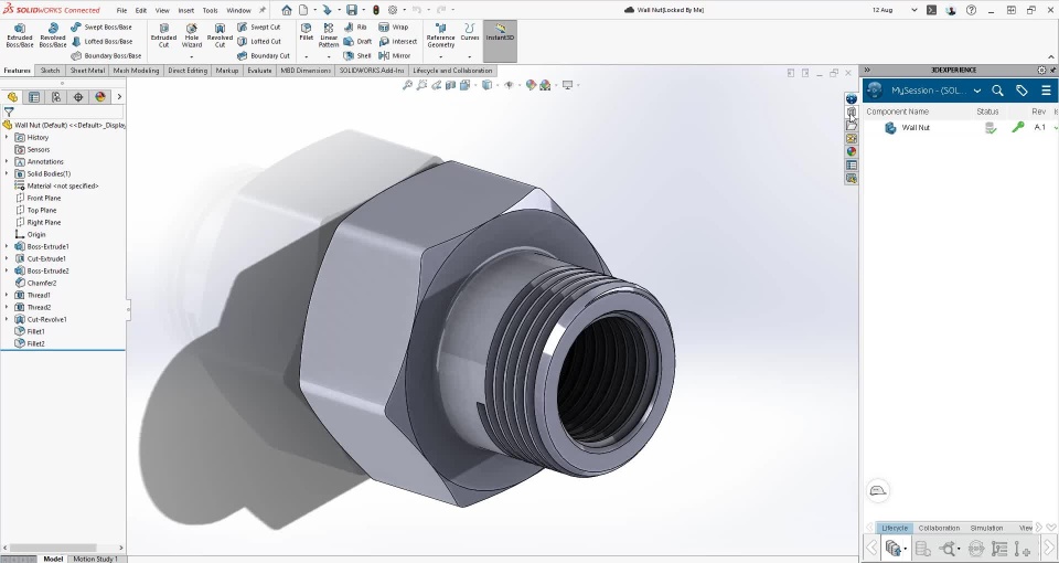

"After the platform update on December 7, you can create a "Connected Design Library" to access bookmarked content in the SOLIDWORKS Task Pane. If you bookmark parts and assemblies on the 3DEXPERIENCE platform, you can use them in the SOLIDWORKS Design Library."
Users can create a "Connected Design Library" by adding a 'Bookmark' to 'Design Library' from 'Task Pane'.
Or
By adding 'Bookmark' from 'Tools -> Options -> System Options -> File Locations -> Design Library'.
Benefits: You can now see content from the 3DEXPERIENCE platform in your Task Pane.
For more information on Connected Design Library please refer to the "Connected Design Libraries"
